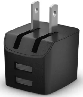

On a AC Wall Outlet
Power the dash cam and charge the battery with a Garmin USB Power Adapter below:
  • A full charge using a Garmin AC power adapter may take 3 to 4 hours
  • When you plug the dash cam into a USB power adapter and push the button to turn it “off”, the device will remain on enough to charge the battery, then fully suspend or turn off.
The included Garmin dual USB power adapter and USB cable for the Garmin Dash Cam X110, Garmin Dash Cam X210, Garmin Dash Cam X310.  For replacement options, see Vehicle Power Kit.
For all other dash cams, the included Garmin dual USB power adapter and USB cables.  For replacement options, see Dual USB Power Adapter.

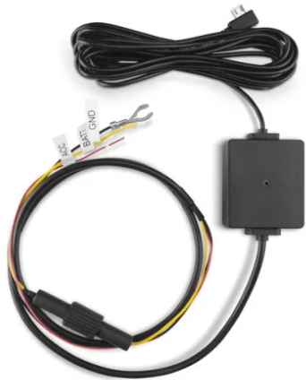

Garmin Constant Power Cable (sold separately on Garmin's online store):
Garmin Parking Mode Cable with USB-C connector (sold separately).
  • Compatible with the Garmin Dash Cam X110, Garmin Dash Cam X210, Garmin Dash Cam X310, Garmin Dash Cam Mini 3
Parking Mode Cable USB-C
Garmin Parking Mode Cable with microUSB connector (sold separately). For compatible dash cams, see product link.
Parking Mode Cable
Garmin USB Power Adapter (sold separately on Garmin's online store):
