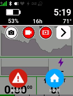

Edge 840 Series | Edge 1040 Series | Edge 1050 | Edge Explore 2
Newer touchscreen Edge computers have have a Camera Control menu accessible from the timer overlay when in an activity profile. Tap the screen to view the timer overlay, and the camera controls will be present if a Varia Vue or RCT715 is paired to the Edge.
Timer overlay with camera controls showing
The default options for quick access camera controls are:
  • Take Photo
  • Save Clip (2 minutes)
  • Film Ride (180 minutes)
Selecting the arrow to the right of the Film Ride option will open the Camera Controls menu. This menu offers the same camera controls as the timer overlay, as well as a status bar showing the progress of a clip that is being saved.

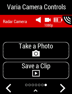

Edge 830 | Edge 1030 | Edge 1030 Plus
During a ride, follow these steps to manually save locked photos and video:
  1. Swipe down from the top of the screen to access the Widgets.
    Status Widget of Edge 830
  2. Scroll to the left or right until you reach the Varia Camera Controls.
    Varia Camera Controls Widget with options for take a photo and Save a Clip
  3. Select either Take a Photo or Save a Clip.
  4. "Save in Progress" will display until the save completes.

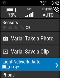

Edge 530
During a ride, follow these steps to manually save locked photos and video on the Edge 530:
  1. From your data screen, select the back button to access the Home page.
  2. Press the Up button to access the Status page.
    Edge 530 Status page with Varia camera controls
    Edge 530 Status page with Varia camera save in progress

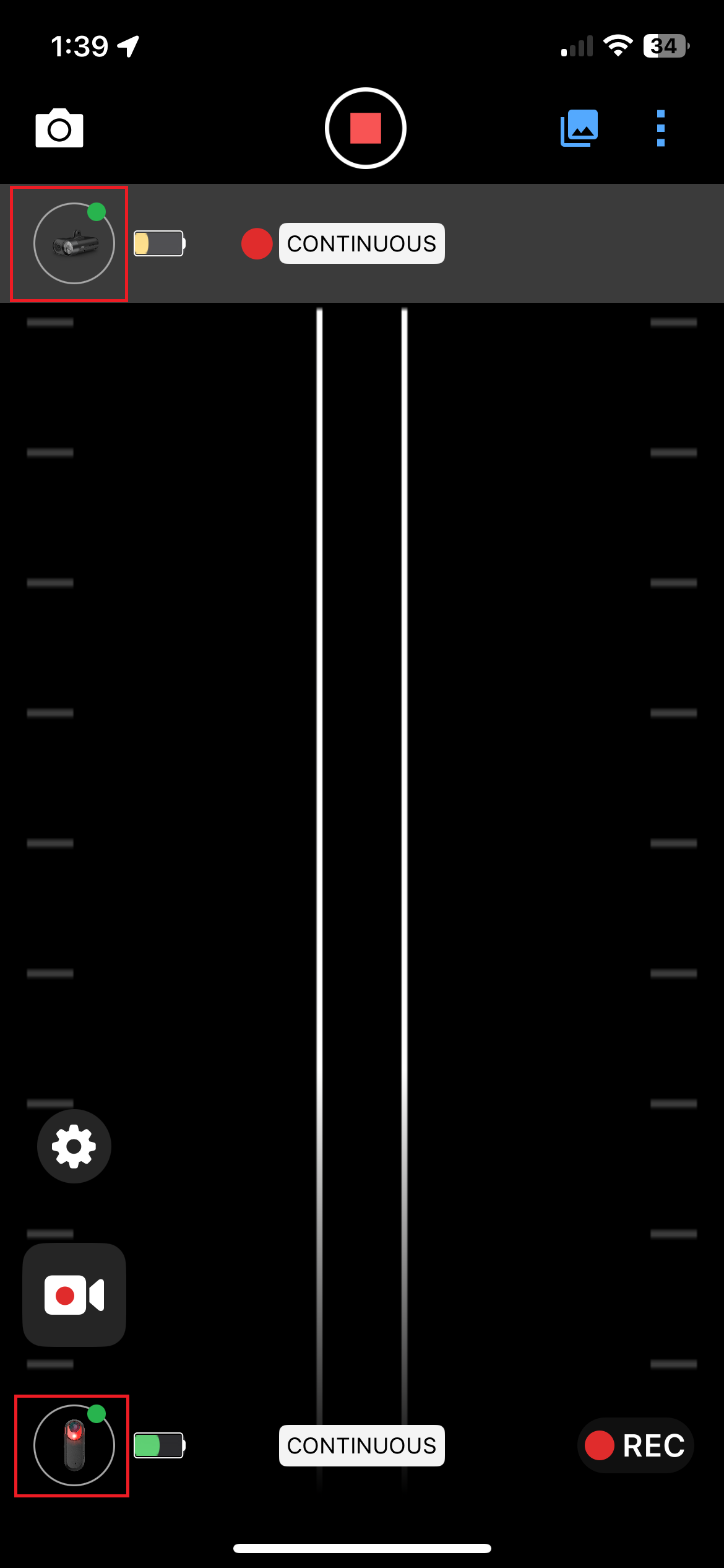

Varia App
The Varia app can be used to control the camera while riding if the Varia is paired to the app. Follow the instructions below:
  1. Pair your device to the Varia app.
  2. Select your Varia by clicking the icon of the device.
    Varia mobile app main screen with RCT715 and Vue paired
  3. Select the Camera icon to open the quick Camera controls. Options presented here are:
    • Continuous Mode
    • Radar Mode
    • Recording Off
To save a photo or clip while riding, select the camera icons at the top of the screen. Taking a picture will show a "photo saved to gallery" message. Saving a video clip will change the video camera icon to a red Stop button, and will show the REC message next to the recording mode for each light. The camera will continue to saved the locked footage until the stop button is pressed.

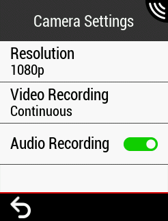

How to Customize the Camera Settings on Your Edge
The camera settings can be adjusted after forming a light network between your Varia and Edge cycling computer. You can customize the following:
  • Resolution: Choose the resolution of the recorded clips.
    • Varia Vue: 4k 30fps, 1440p 30fps, 1080p 60fps, 1080p 30fps.
    • Varia RCT715: 1080p 30fps, 720p 30fps.
  • Video Recording:
    • Continuous: Video will continuously record to the SD card on a loop while the device is powered on.
    • On Radar Activity: Video will only be captured when the camera is activated due to radar threats.
      • Varia Vue requires a compatible radar to be part of the light network for this mode. If no compatible radar is detected the Vue will default to Continuous mode.
    • Off: Video will not record.
  • Audio Recording: This can be toggled on or off to enable or disable the mic built into the Varia.
  • Image Stabilization (Varia Vue only): The electronic image stabilization can be toggled on or off.

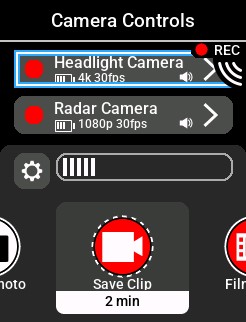

Follow these steps to adjust the camera settings:
  1. From an activity profile, tap the screen to open the timer overlay.
  2. Select on the right of the Camera Control options.
    Edge timer overlay with camera controls showing
  3. Select your device from the Camera Controls menu.
    Camera Controls menu with settings for Headlight and Radar cameras and camera controls
  4. Choose a setting to adjust.

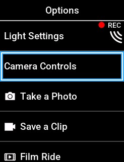

Edge 540 | Edge 540 Solar
  1. From an Activity Profile, press three black dots stacked vertically to open the Options menu.
  2. Select Camera Controls.
    Edge 540 options menu with Camera Controls highlighted
  3. Select a device.
    Camera Controls menu with Headlight Camera highlighted and options for camera controls

Edge 530
NOTE: Not all camera settings for the Varia Vue may be present. To adjust those settings, use the Varia app.
  1. From the Home page, scroll up to the Status page and select Light Network.
    Edge530 Status page with Light Network Highlighted
  2. Select Radar Camera or Headlight.
    Light network settings page with radar camera highlighted
  3. Scroll down and select Camera Settings.
    Radar camera sensor menu with Camera Settings highlighted
    camera settings menu with resolution, video recording, audio recording options
