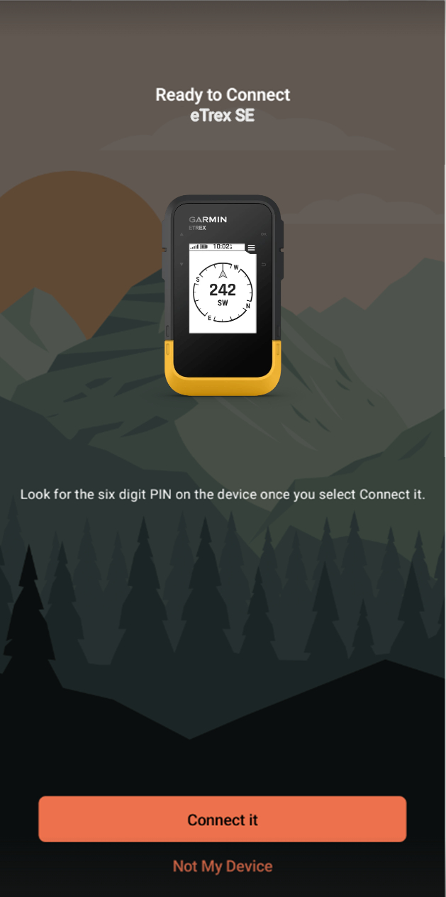

Allow Enough Time for the Phone or Tablet to Find the eTrex
During the pairing process it can take 20+ seconds for the phone or tablet to find the eTrex.
If your phone or tablet does not find the device right away, allow more time. Once the device has been found, select Connect it.
Ready to Connect eTrex SE
A six digit pin will appear on the device after you select Connect it.
