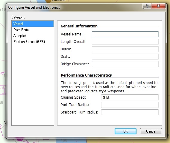

In CE go to Tools > Configure Vessel and Electronics

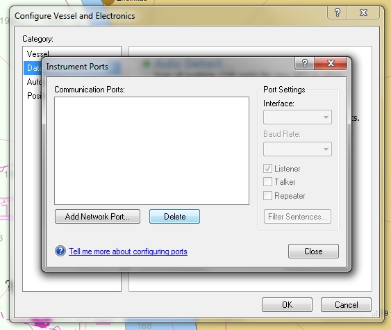

Select Data Ports > click on Port Settings

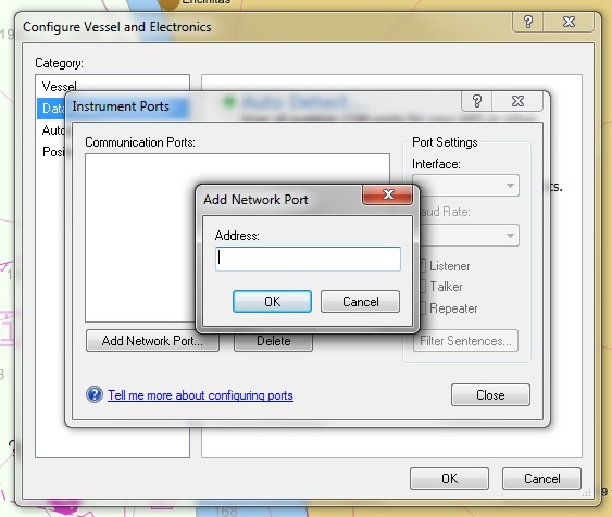

Select Add Network Port
If the default IP address is not changed on the WatchMate Vision or XB8000 transponder, this is the address format:
 192.168.15.1:39150
If changed, adjust these numbers accordingly.
Click OK > close > OK
