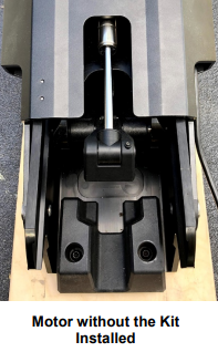

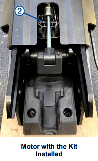

Determining Whether or Not the Latch Kit is Installed on the Motor
  1. Place the trolling motor into the deployed position
  2. Examine the space below the gas spring at the end of the mount (1)
If the motor has the kit installed, the additional bracket (2) located below the gas spring will be visible
Force TM Gas Spring Location on Motor    Force Motor With No Latch Kit Installed    Motor with Latch Kit installed
