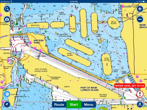

If you happen to see the warning symbol in the lower-right corner of your screen, this indicates the water level has been set in a positive direction. This is to warn you the depth information on the chart is showing deeper water available than the original chart information indicates. Tap the warning to display more information. You can adjust the water level manually in your Map Options or reset defaults at the bottom of the page.
Water Level Warning
 Water level warning in lower-right of screen showing exclamation mark in a red circle.
