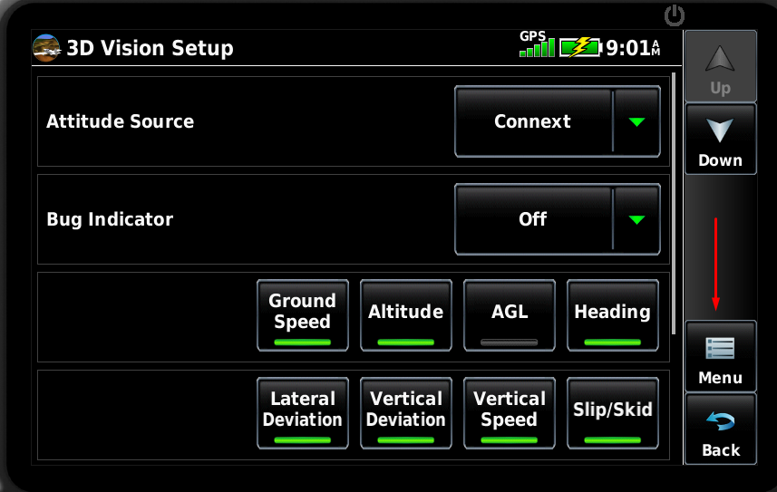

  4. In the 3D Vision Setup page, press Menu on the right-hand side.
  5. Press Enable Panel Mount.
  6. Change the Attitude Source to Internal.
