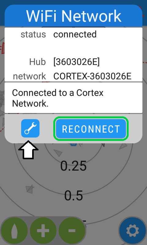

From any view tap the Wi-Fi icon on the top banner.
App Wifi Icon Top Right Corner
The Wi-Fi network view will appear.
Connected Cortex with Wrench Icon
Tap the wrench icon to be directed to the Cortex add Boat Network view.

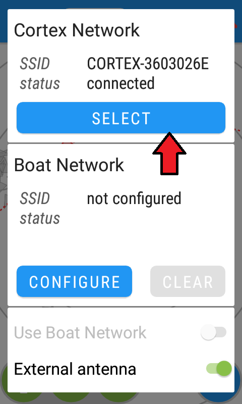

Cortex Boat Network
Now tap select. The SSID banner will have an SSID. The box above this banner displays the Wi-Fi SSID's that are being transmitted and being seen in real time.
SSID Displaying on App Banner
Tap on the SSID of the device. It will then populate the SSID banner and press select.
The handset should now be re-connected to the M1and the Wi-Fi Icon on the handset and on the M1 POD should show connection (white on handset) green on the M1.
