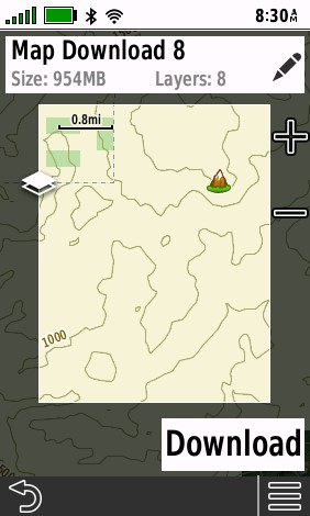

  6. Use the available actions to select an area of the map to download:
    Alpha 300 Select Map Area for Download
    • Drag the map to view different areas.
    • Pinch or spread two fingers on the touchscreen to zoom in and out of the map.
    • Select Zoom in Button and Zoom out Button to zoom in and out of the map. You may need to zoom in to a scale of 2 miles or less if certain layers like Satellite or USGS quadrangle map are needed.
    • Double-tap the map to quickly zoom in.
    • Select Map Layers to show or hide currently installed map layers.
    • Select Edit Pencil at the top of the screen to edit the name, storage location (internal or SD card), or which map layers to include in the download. After making changes, select Back Arrow to return to the view of the map download area.
  7. Select Download.
    NOTE: If the Download option is grayed out, you will need to adjust the area or selected layers to reduce the download size. If you receive an error that the selected maps have already been downloaded, see - Error All Selected Maps in This Area Have Already Been Downloaded to the Device.

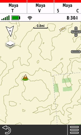

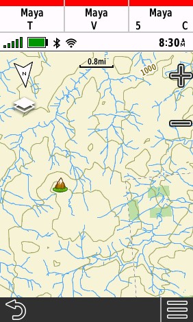

Enabling or Disabling Specific Outdoor Maps+ Content
Select Map Page Icon to access the map page, then select Map Layers to choose which Outdoor Maps+ content should be displayed. The examples below show the Hydro layer being enabled and disabled.
Hydro Layer
Hydro EnabledHydro Disabled
Alpha 300 Hydro Layer OnAlpha 300 Hydro Layer Off
