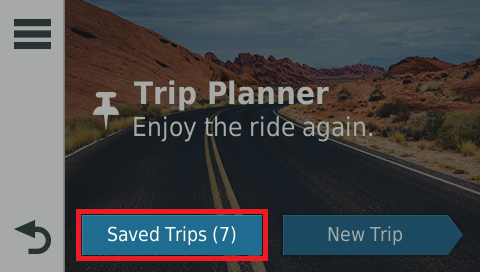

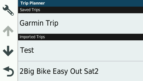

3. Touch Saved Trips
PND zumo 396 - Trip Planner - saved trips

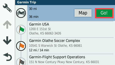

4. Select the Trip
5. Touch Go!

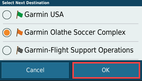

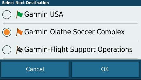

6. Select the Next Destination of the Route
  • Select the Green Flag to route from your current location to the beginning of the route, and then the full trip.
  • Select the Orange Flag to skip the starting location and route from your current location to the waypoint selected in the route, and then the remaining trip destinations in order.

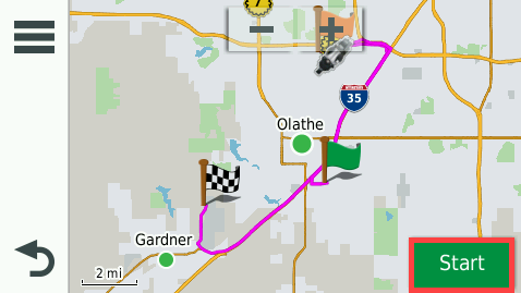

  • Select the Checkered Flag to route from your current location skipping all the points in the route and taking you the quickest way to the destination point.
7. Touch OK
8. Touch Start
