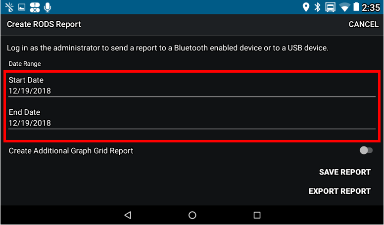

5. Select the date range needed

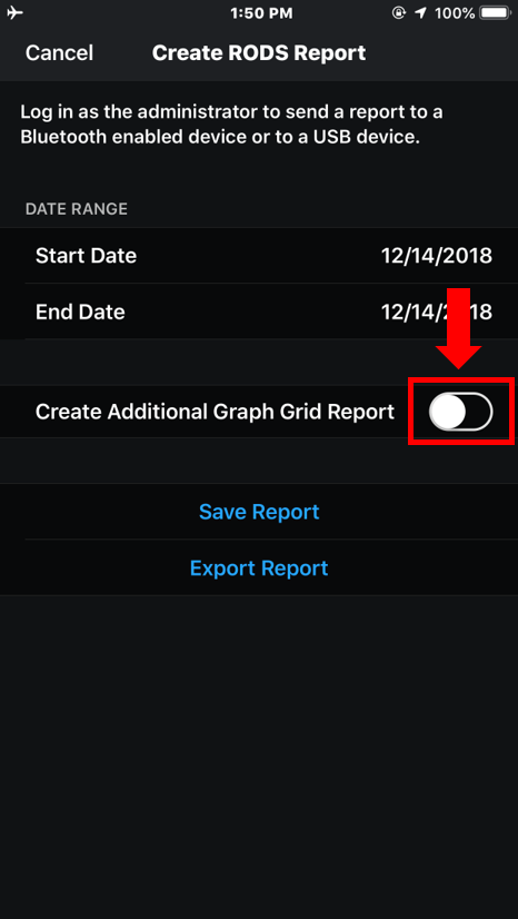

6. Touch Create Additional Graph Grid Report
    • Selecting this option creates the .html file

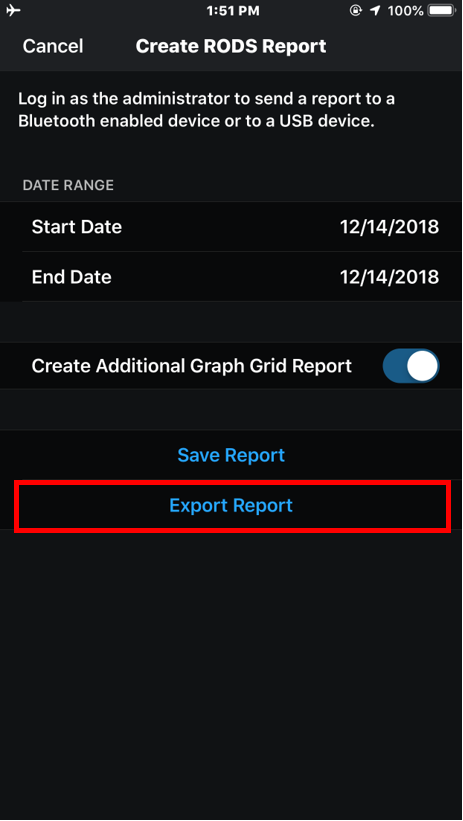

7. Touch Export Report
    • NOTE: The device will need to be actively paired with the Garmin eLog ELD to export the RODS report.
8. Use the mobile device's sharing options to export the file

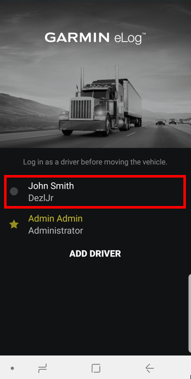

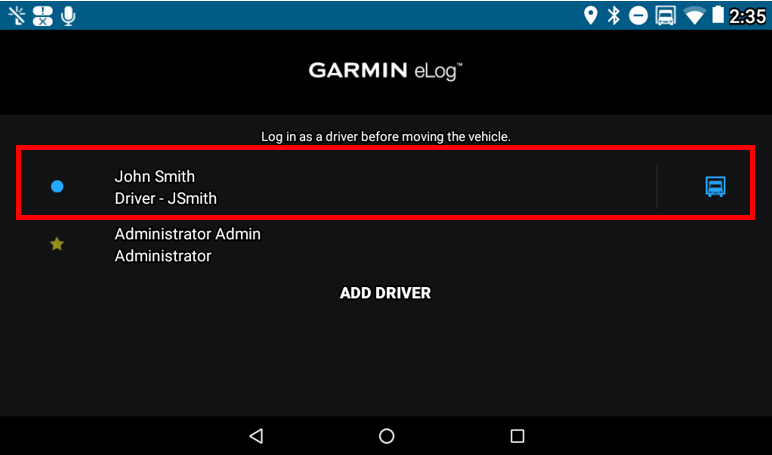

2. Sign in to your driver profile

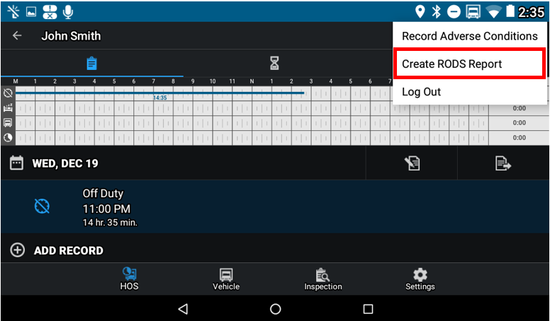

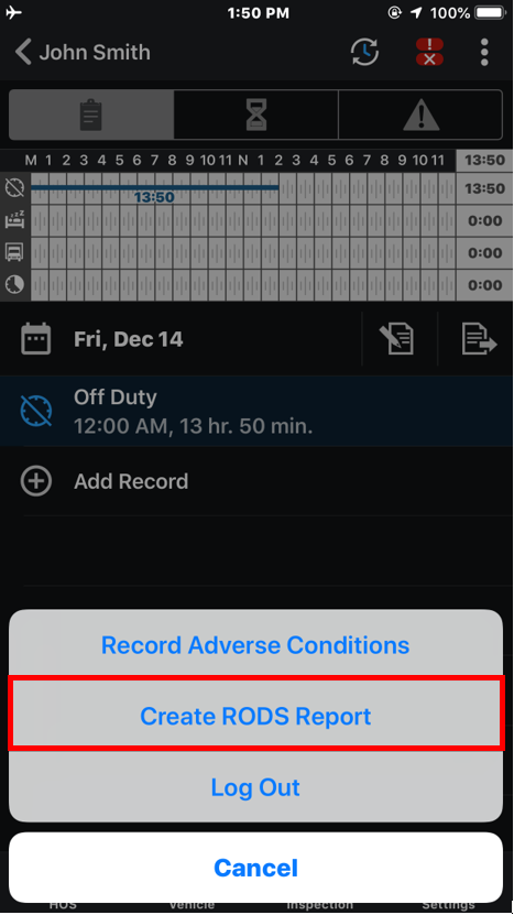

3. Touch the menu button (3 dots) in the upper right-hand corner
4. Touch Create RODS Report

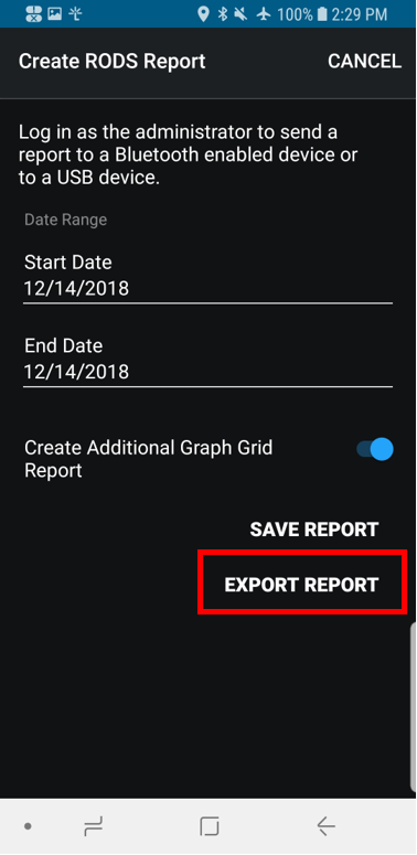

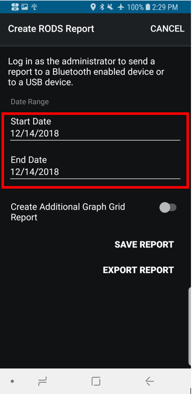

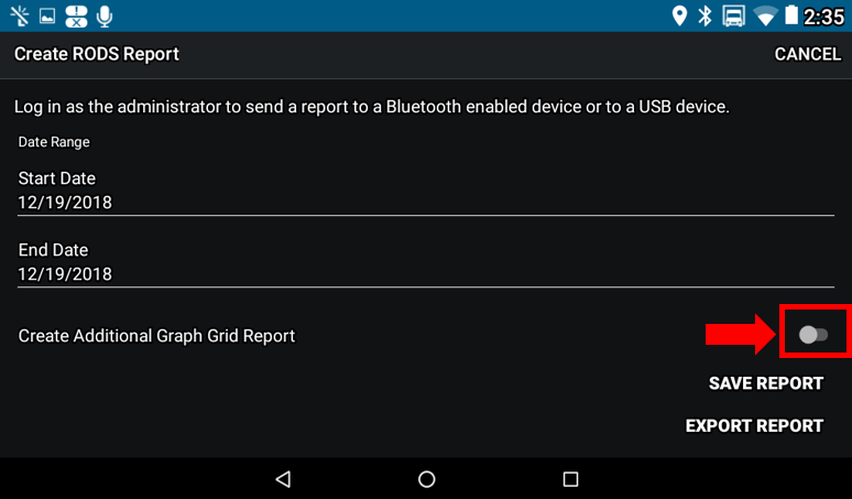

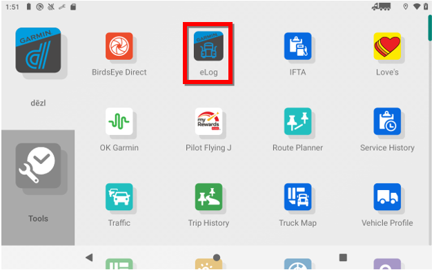

1. Open the Garmin eLog App while in the vehicle

2. Sign in to the driver profile

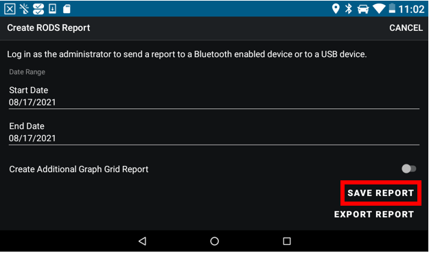

7. Touch Save Report
    • NOTE: The device will need to be actively paired with the Garmin eLog ELD to save the RODS report.
8. Use the sharing options to export the file

1. Open the Garmin eLog app while in the vehicle
    • NOTES:
      • The device will need to be actively paired with the Garmin eLog ELD to save the RODS report.
      • The Export button will not work on these devices.
8. The files will be saved to the device's internal storage in the File Manager App
9. Access the files on a computer to email them to your Motor Carrier
    • The Garmin eLog ELD and the Garmin eLog App MUST be paired.
    • Selecting this option creates the .html file.
