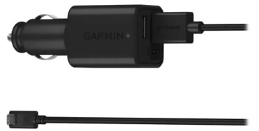

Make Sure Your Device is Plugged Directly Into Your Vehicle With its Original Garmin Power Cable
- Do not use a splitter, USB, or third-party cable
- Ensure the cable is securely inserted into the port on the back of the device
- Your vehicle power cable and receptacle need to be debris-free and clean in order to make a proper mechanical and electrical connection
- Ensure the cable is plugged in all the way to the cigarette lighter or 12V outlet and the LED light is lit
- See Buying Automotive Accessories Directly from Garmin for instructions to purchase a replacement Garmin power cable
