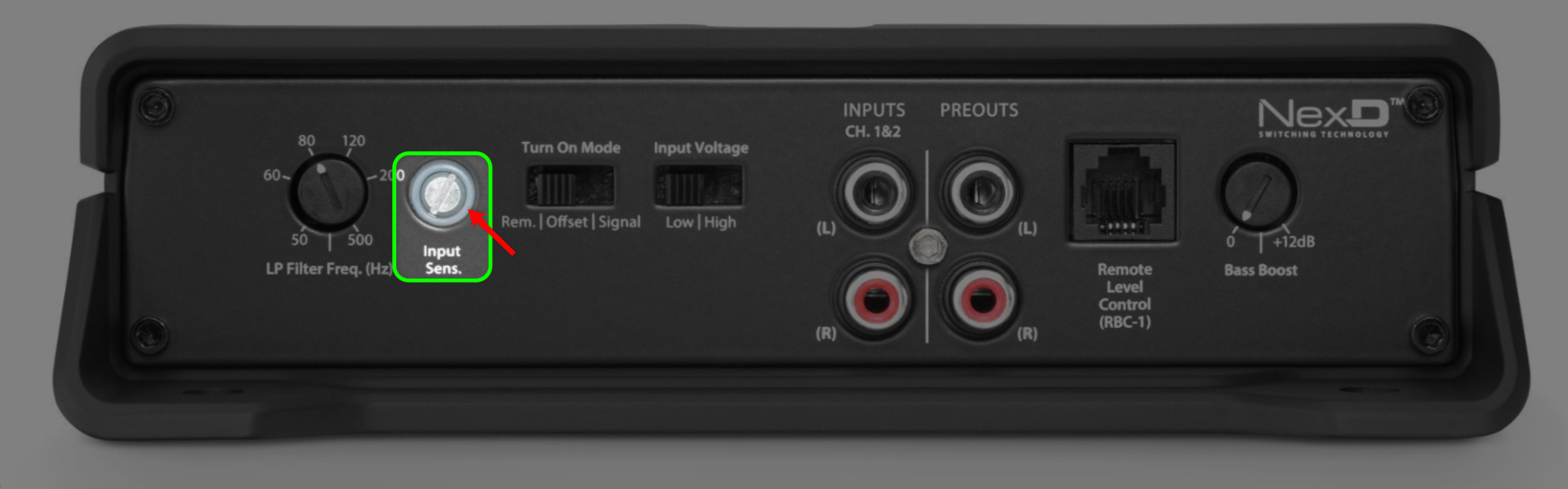

Setting the Input Sensitivity on JD Amplifiers is made simple thanks to their built-in clipping indicator. The illuminating clipping indicator encircles the Input Sensitivity control knob(s) at the amplifier's control panel, making it easy to monitor during the level setting procedure.
Clipping indicator highlighted in the image below:
NexD Amplifier with a highlight of the clipping indicator
