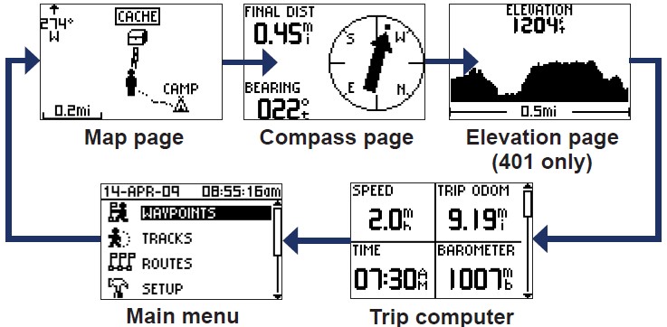

Main Pages on a Foretrex 301 and 401
All of the information needed to operate the Foretrex® 301 and 401 outdoor navigators is found on the following five main pages: the map page, the compass page, the elevation page (Foretrex 401 only), the trip computer page, and the main menu.
Press the PAGE button to navigate through the main pages, then press ENTER to access the pages option menus.

Map Page
Your position on the map is represented by Foretrex 301 and 401 Person Icon . As you travel, the position icon moves and leaves a track log (trail). Waypoint names and symbols are also shown on the map.
NOTE: Press Foretrex Up Arrow to zoom out or Foretrex Down Arrow to zoom in.
The Foretrex device automatically rotates the map as you move, so that the waypoints ahead of you always appear above your position. The heading indicator shows the direction you are heading.

Compass Page
The compass page guides you yo your destination by displaying a compass and a bearing pointer.

Elevation Page
The elevation page shows your elevation. Press Foretrex Up Arrow to zoom out or Foretrex Down Arrow to zoom in.

Trip Computer
The trip computer displays your current speed, average speed, maximum speed, trip odometer, and other useful statistics. Use Foretrex Up Arrow and Foretrex Down Arrow to see more fields.
Main Menu
The main menu gives you access to setup screens including waypoints, tracks, and routes. The main menu displays the current date and time along the top of the screen. Use Foretrex Up Arrow and Foretrex Down Arrow to select from the list of menu options.
