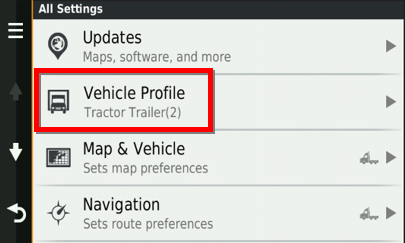

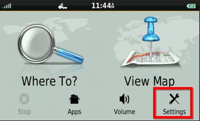

2. Touch Settings
3. Touch Vehicle Profile

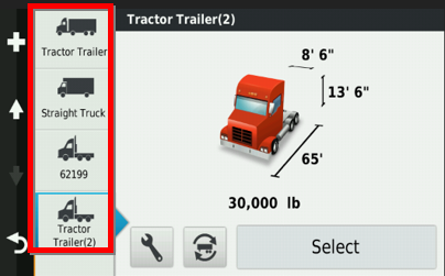

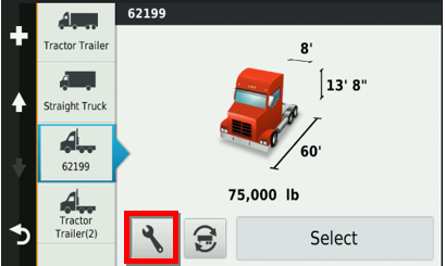

4. Select the profile
5. Touch the wrench icon
You Can View/Edit the Following Fields from this Screen:
  • Height: Measurement from the ground to the highest point on the tractor or trailer
  • Width: Measurement of the widest point of the tractor or trailer
  • Overall Length: Measurement of tractor and trailer from end to end combined
  • Gross Weight: Ensure the actual weight of the vehicle has been set for the gross and axle weight on the profile, and not the maximum possible weight of the vehicle
    • Setting the profile for the maximum possible weight may result in unneeded restrictions
  • Max Weight per Axle:  Trucking Devices and Axle Weights
  • Number of Axles: The total number of axles on the semi-trailer being pulled by the truck tractor
  • Max Speed: If you're governed by speed, enter your maximum speed to create a more realistic Estimated Time of Arrival
    • Setting the max speed may also adjust the routing course and provide additional route suggestions
  • Odometer: Miles on the tractor
  • VIN: Vehicle VIN number
  • Tractor Number: The DOT or MC number assigned to the truck tractor
