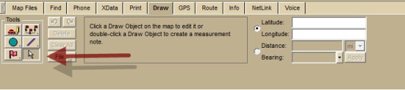

  2. Click the Draw tab.
  3. Click the Select tool.

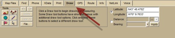

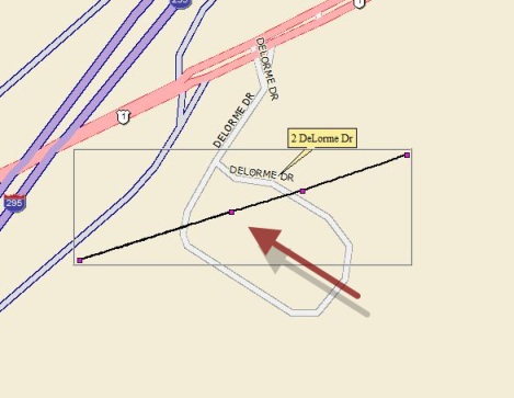

  4. Select the object you want to break. A box displays around the active line and the shape points used to create the line display as small magenta squares.

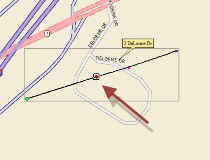

  5. Click the shape point where the line is to be broken. The shape point will now display as a red circle.

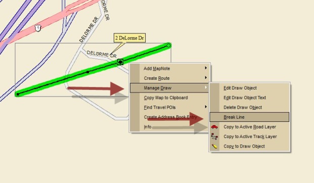

  6. Right-click the red circle, point to Manage Draw, and click Break Line.
