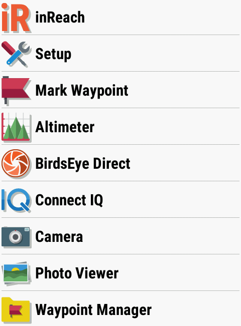

Menu Style
When editing the menus, you can also choose the Menu Style for how the icons are arranged on the screen as Grid or List. Examples of both can be found below.
Grid Menu Style
Grid Menu
List Menu Style
List Menu
