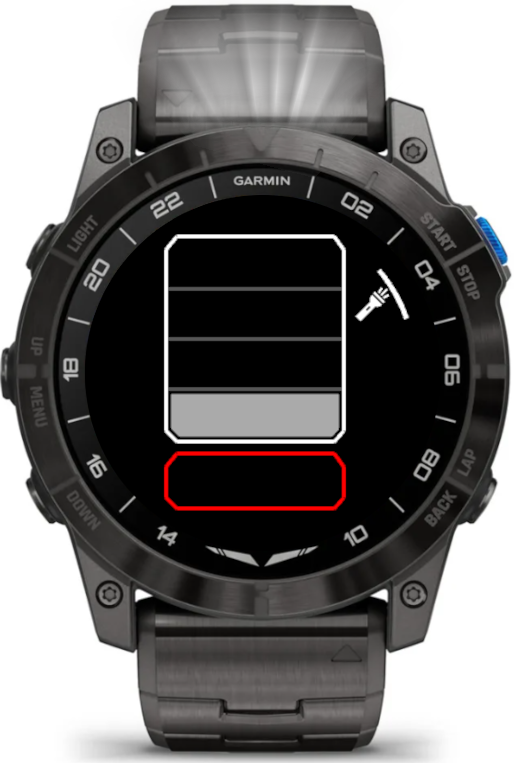

    Brightness Levels
    Press UP or DOWN to adjust the brightness level.

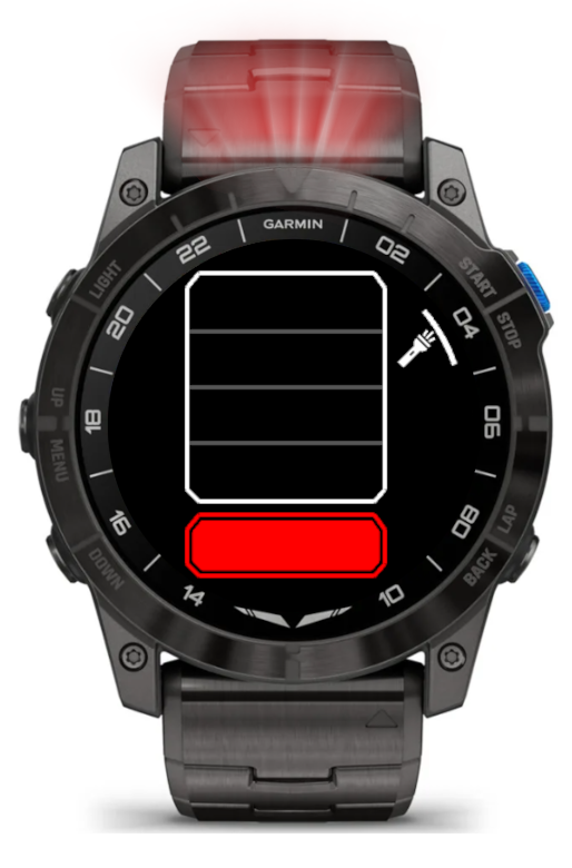

    Red Light
    Press UP or DOWN until the red bar is selected.
    D2 Mach 1 Pro flashlight menu red

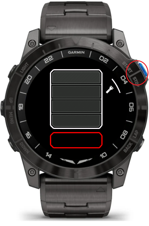

    On/Off
    Press START to turn the flashlight on or off temporarily while staying in the flashlight settings.
