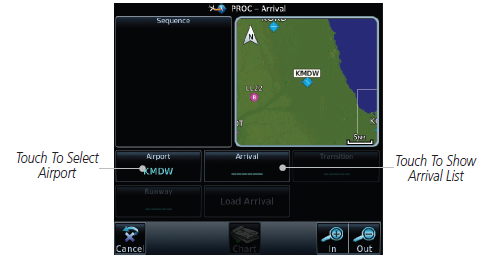

- Touch the PROC key on the Home page and then touch the Arrival key. Confirm that the intended airport is shown, or touch the Airport key and select the desired airport.

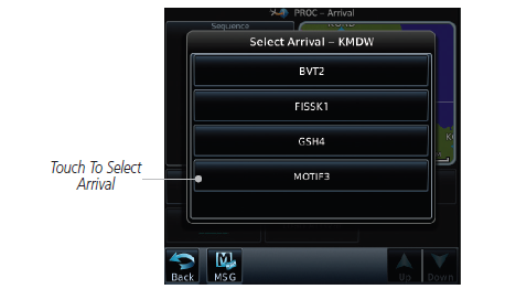

- Touch to select the desired Arrival.

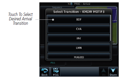

- Touch the Transition key and then touch the key for the desired transition.

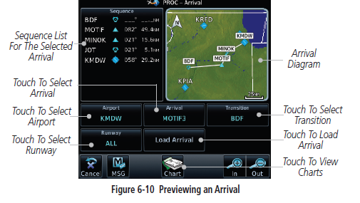

- After selecting the runway, the Arrival page with a map preview will be displayed.

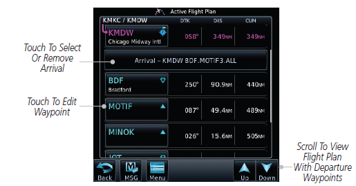

- Touch the Load Arrival key. The Active Flight Plan page will be displayed.
