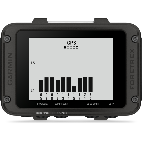

    The bars represent the strength of each satellite signal received (the number of satellites appears below each bar). White bars indicate the device is collecting data. Solid bars indicate the device has acquired satellite signals.
    Satellite Strength
    Press UP or DOWN to toggle between satellite systems when MULTI-GNSS is enabled. MULTI-GNSS can be enabled under SETUP > SYSTEM > GPS MODE.

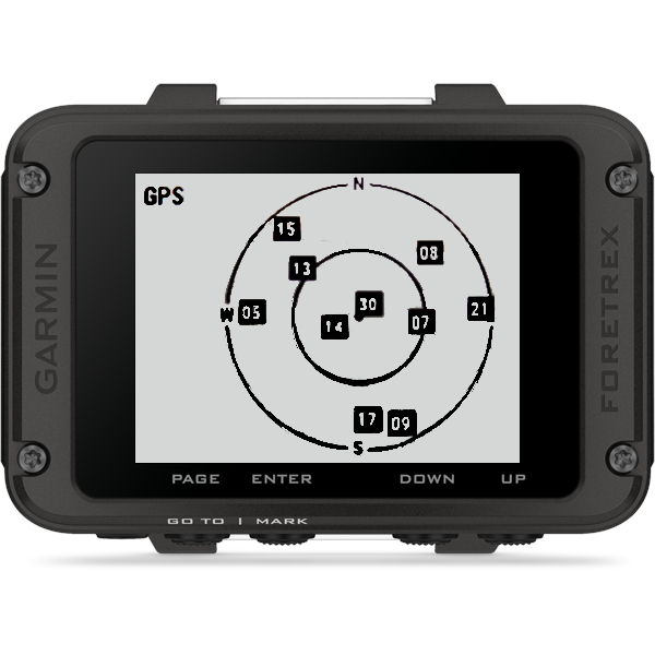

  2. Press ENTER to switch to sky view.
    The location of the satellites from which you are receiving signals appears.
