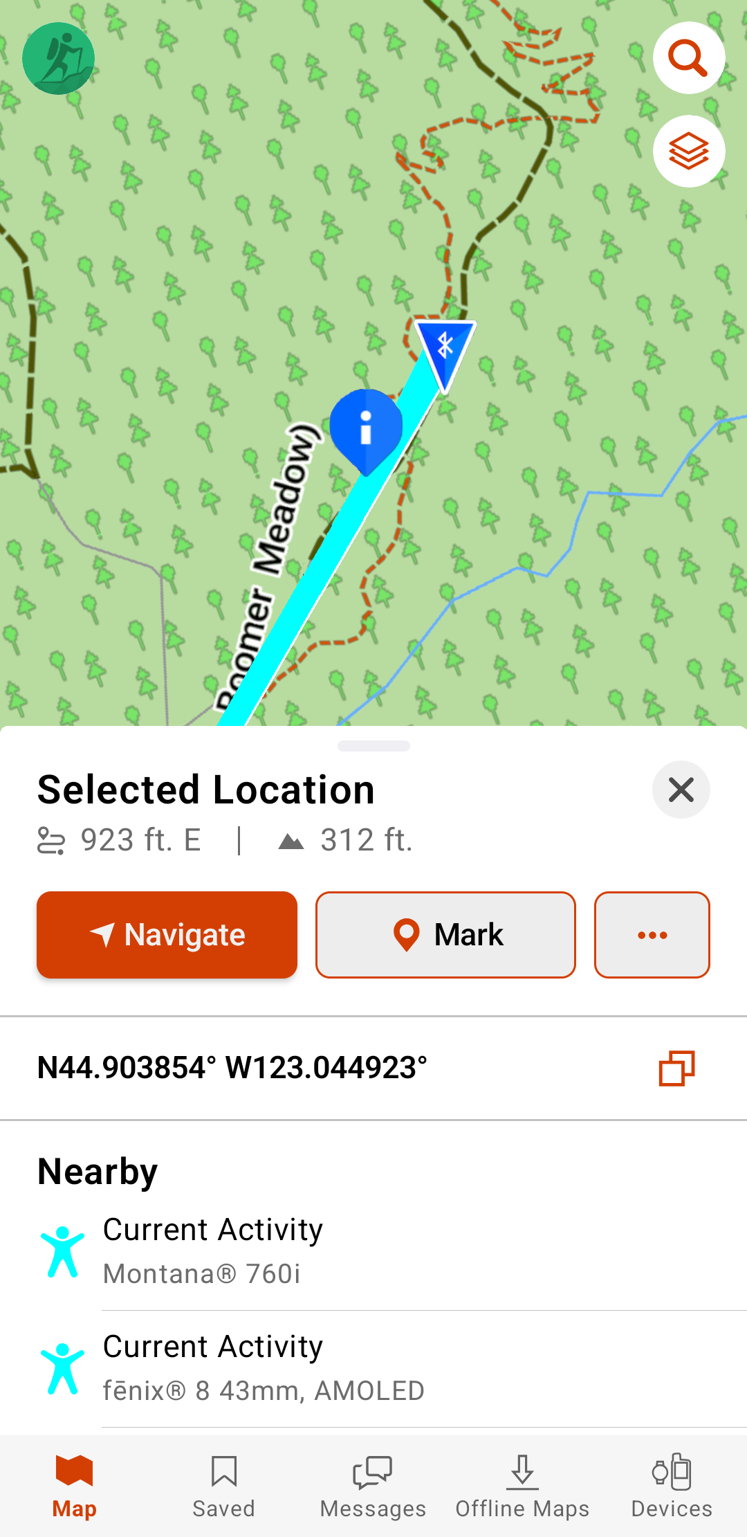

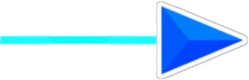

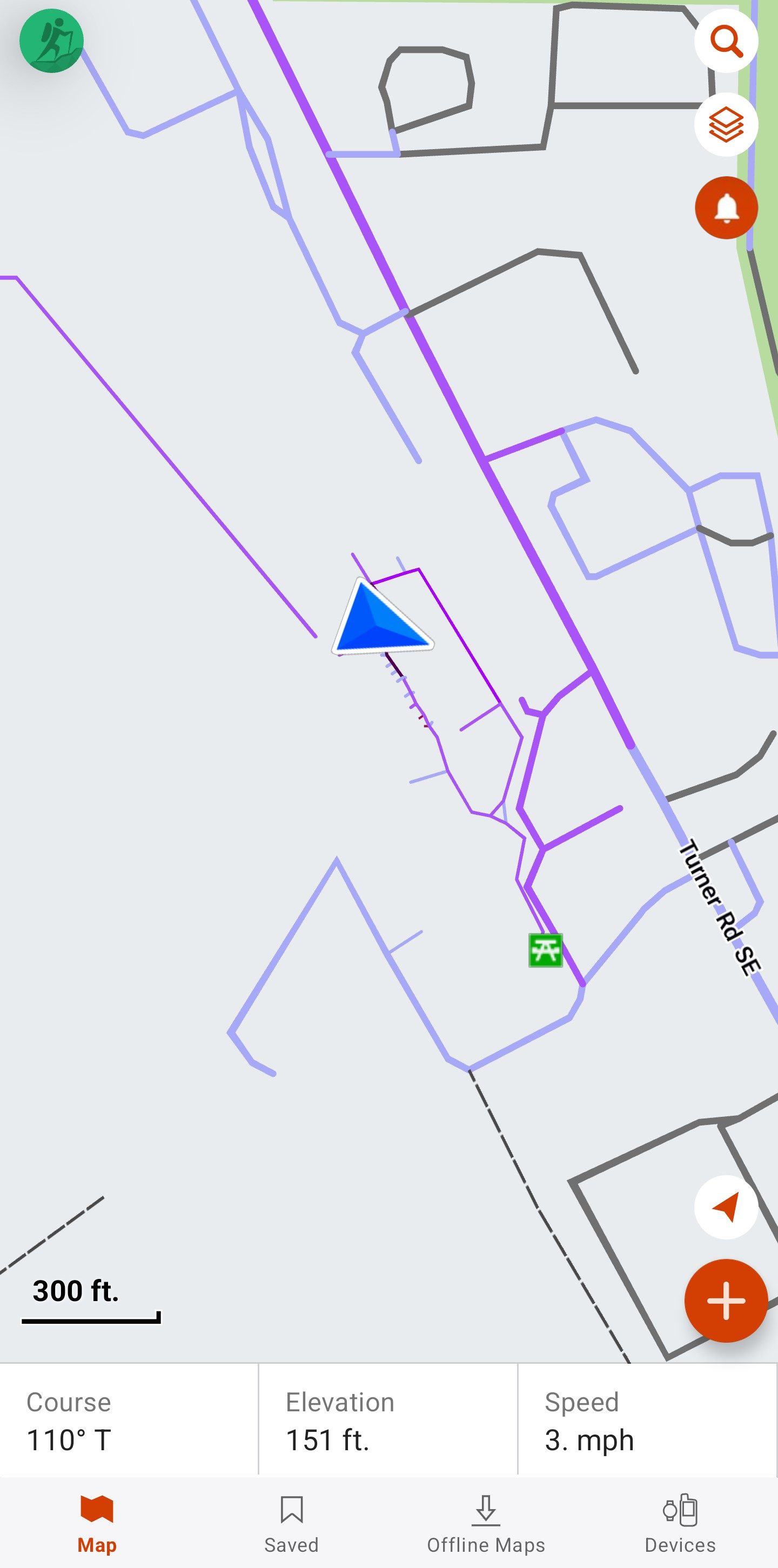

Blue Triangle Current Location
The blue triangle represents your location on the map. Your approximate location on the map is where the different shades of blue converge inside the triangle. When recording an activity or track on a connected Garmin device, a light blue line of your recorded path will be displayed behind the triangle as you move.
Arrow With Line
If multiple Garmin devices are connected and recording simultaneously, there may be overlapping lines for each device. You can tap on the map to see a list of the tracks or activities being recorded from each connected device.
Multiple Activity Recordings

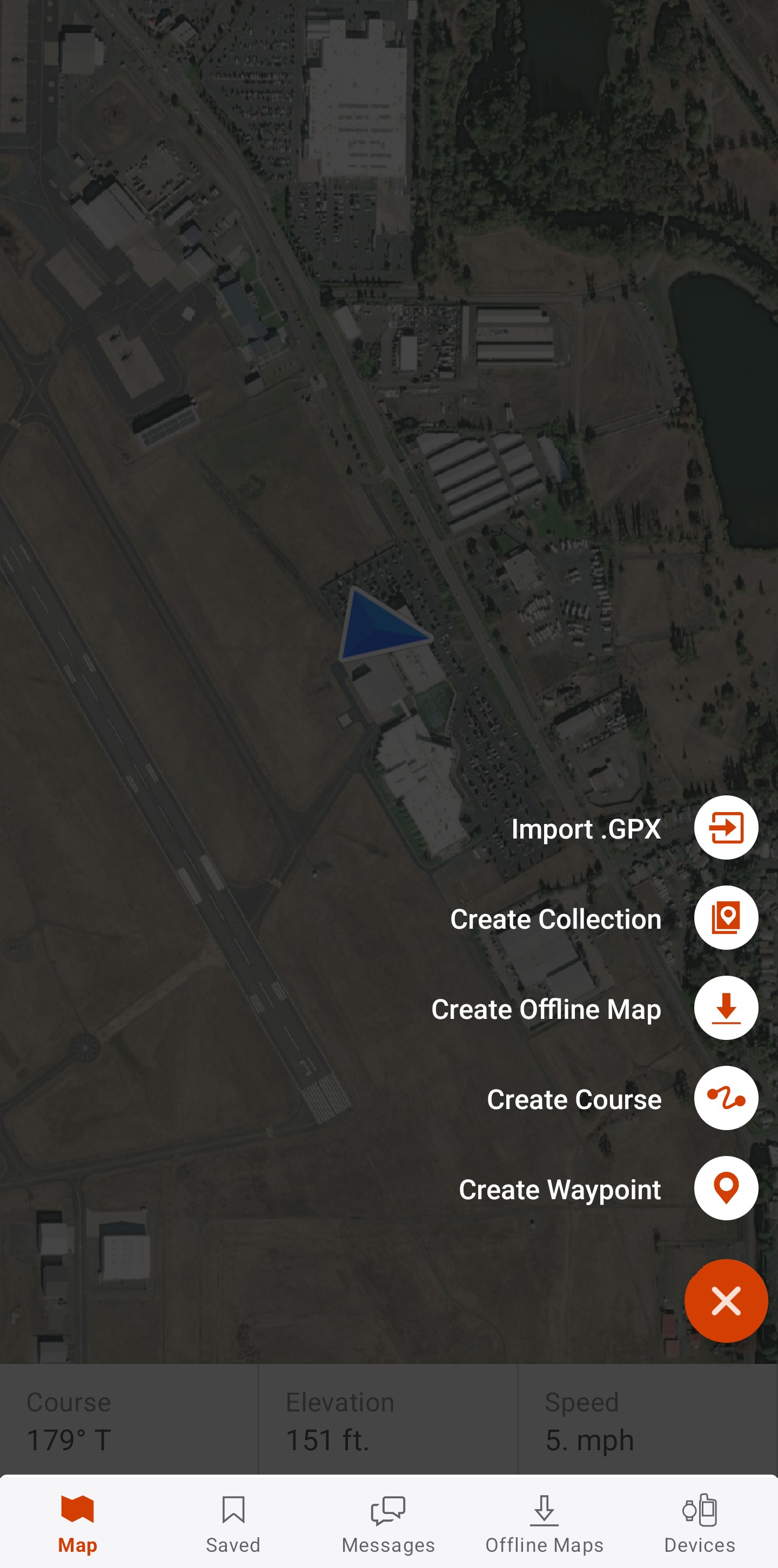

Plus SymbolIcon
Selecting the plus icon gives you options to create a waypoint, create a course, create an offline map, create a collection, or import a GPX file.
Garmin Explore App Add

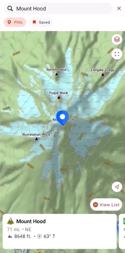

Magnifying Glass Search Icon
The search feature allows you to search for points of interest (POI) or items in your library. When you select a POI the app will show you the location on the map. Swipe left or right through the search results at the bottom of the map or select View List.
By default the app will stream maps for searching when an internet connection is available. Address search is only available with an internet connection.
If no internet connection is available, or if Offline Maps Only is toggled on in the Map Settings, the app will only search using offline maps. POI search will still be available without an internet connection as long as a TopoActive map for the area being searched has been downloaded.
For more details on Map Settings, see - Map Display Settings in the Garmin Explore App.

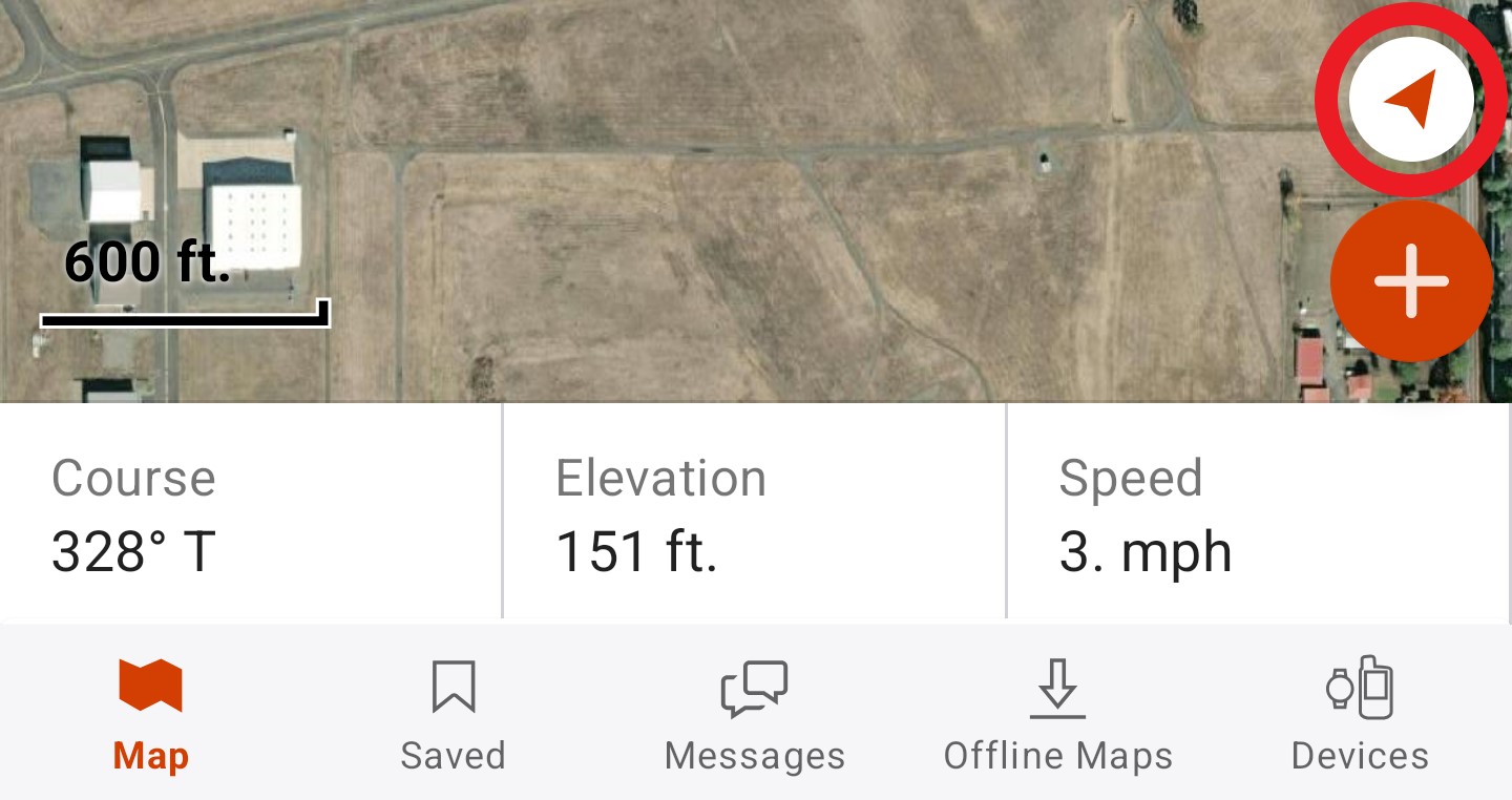

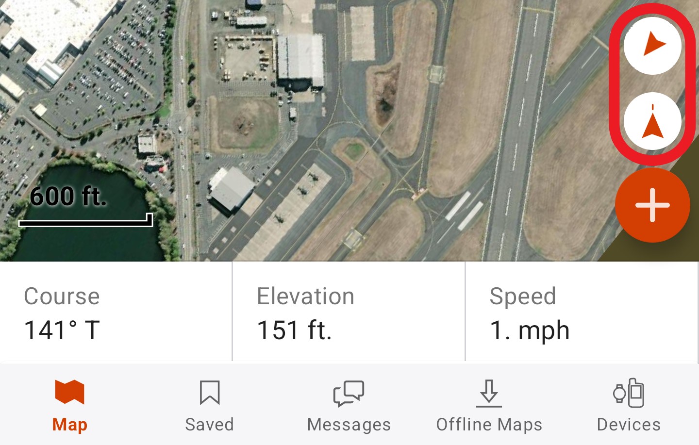

Pointer Arrow Position Pointer
The position pointer arrow gives you two options for navigation: track up and north up. These settings are changed by tapping on the arrow.
If you have panned over to a different area of the map, tapping the arrow will re-center the map over your current location.
Track Up
When the app is in track up mode you will see a line above the arrow. That indicates the app is using track up mode. This will orient the map so the arrow on the map will always have your direction of travel towards the top of the map. The arrow below will show the direction of North.
Garmin Explore App Track Up Arrow
North Up
The north up option will only show the arrow. With north up enabled the top of the map will always be north of your location. The arrow on the map will change based on your direction of travel.
Garmin Explore App North Up Arrow
