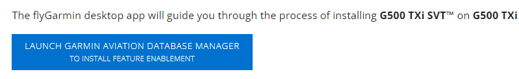

This will take you to the Install Enablements section. Plug your SD Card into your computer and click the blue "Launch Garmin Aviation Database Manager" button to launch the Garmin Aviation Database Manager application.
GADMSVT
Once the Garmin Aviation Database Manager application is open, follow the prompts to install the feature enablement onto your SD Card.
