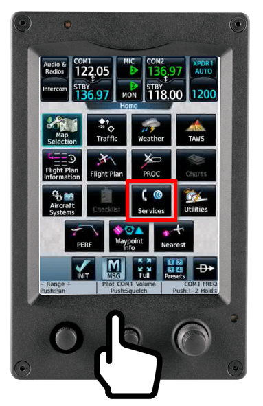

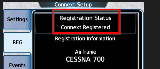

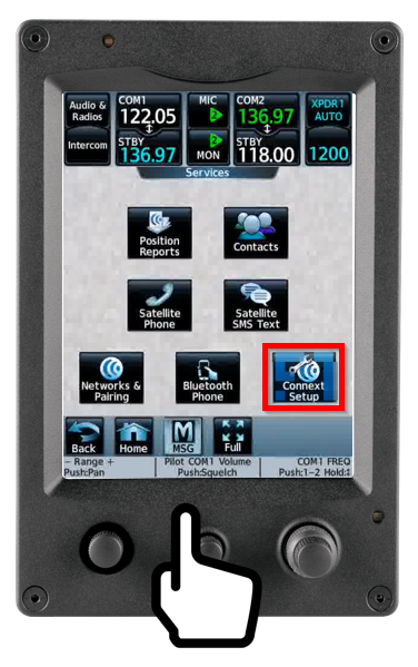

For Garmin Integrated Flight Deck (GIFD) Installations:
  1. From Home on the GTC, select Services.

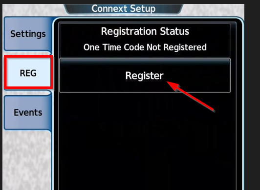

  2. Select Connext Setup.
  3. Select the REG tab and then select Register to enter your One-Time Code.
  4. The registration status should show Connext Registered once the One-Time Code has been entered.  *Please be aware it can take up to 5 minutes for the One-Time Code to register.

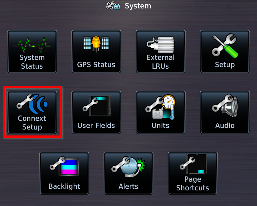

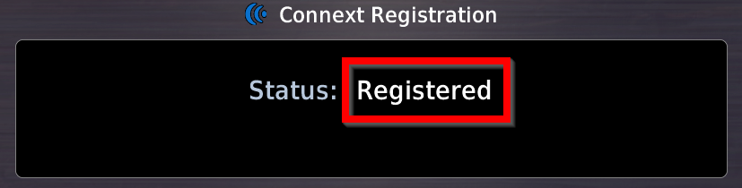

For GTN™ Xi GPS navigator Installations:
  1. From the GTN Home page, select System.

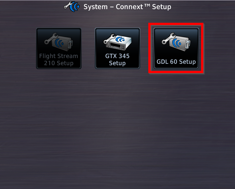

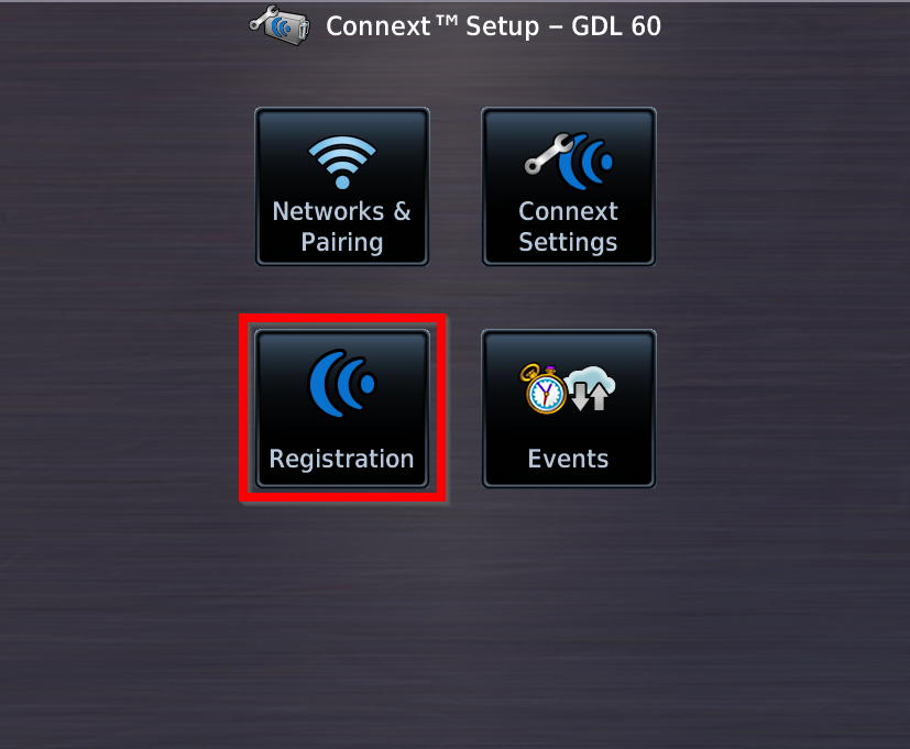

  3. Select GDL 60 Setup.
  4.   Select Registration.

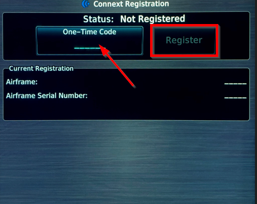

  5. Enter the One-Time Code and then select Register.
  6. The registration status should now show "Registered".  *Please be aware it can take up to 5 minutes for the One-Time Code to register.
