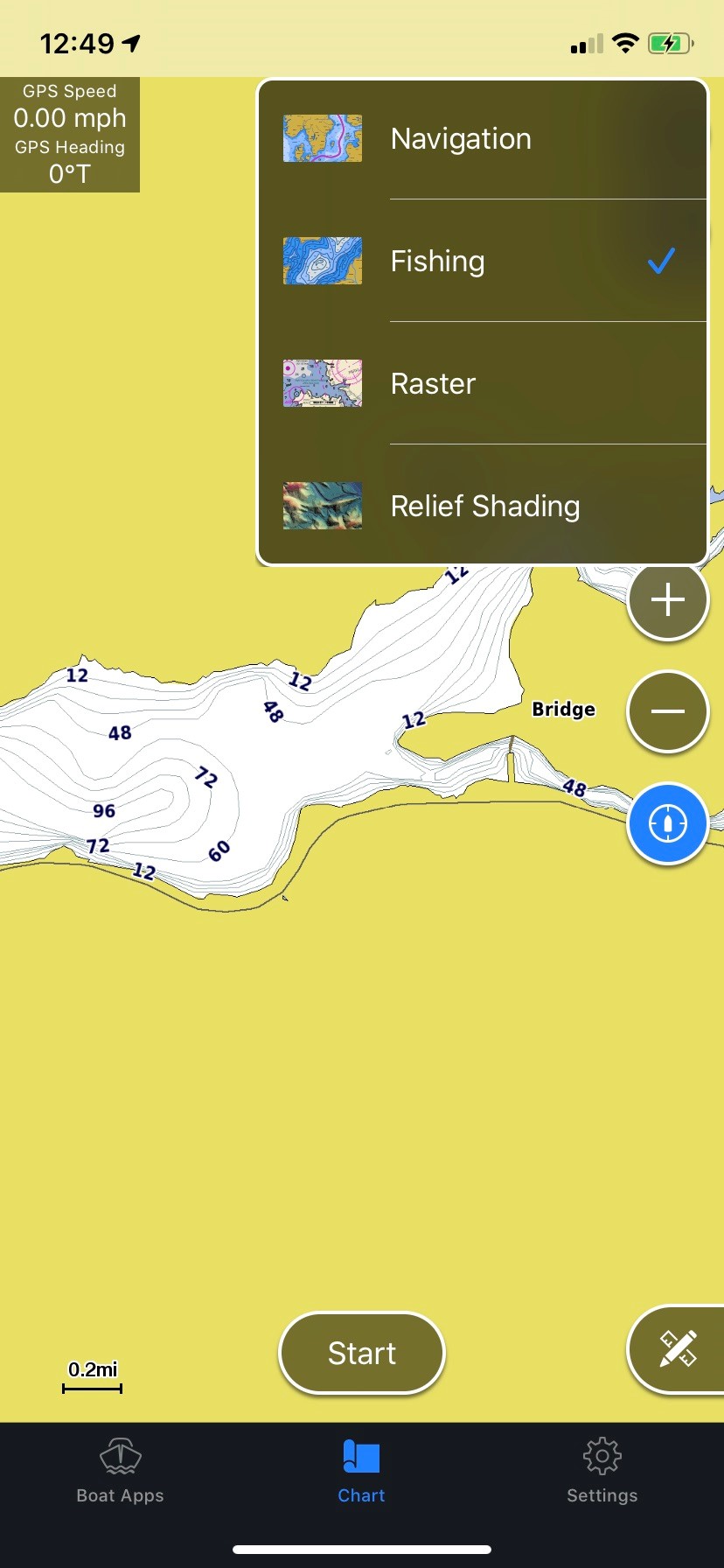

NOTE: To download Fishing, Raster or Relief shading charts, select the appropriate chart to download.
  1. In ActiveCaptain select ActiveCaptain Icon Example
  2. Choose the preferred chart
ActiveCaptain Chart Selection Example
