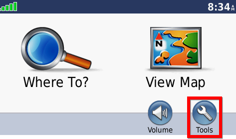

1. | Touch Tools | |

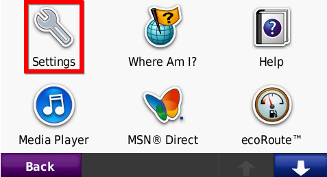

2. | Touch Settings | |

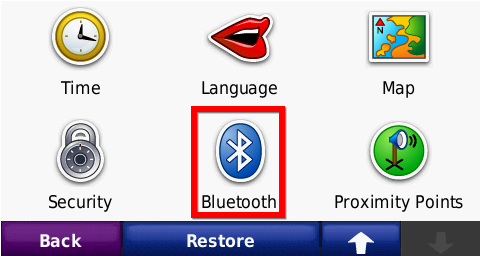

3. | Touch Bluetooth | |

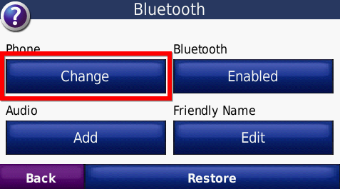

Touch Change
5. | Touch the device you wish to remove | |

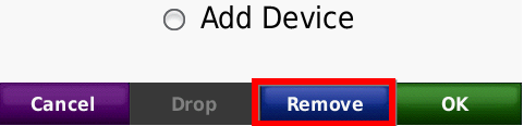

6. |
Touch Remove
7. | Touch Yes |
