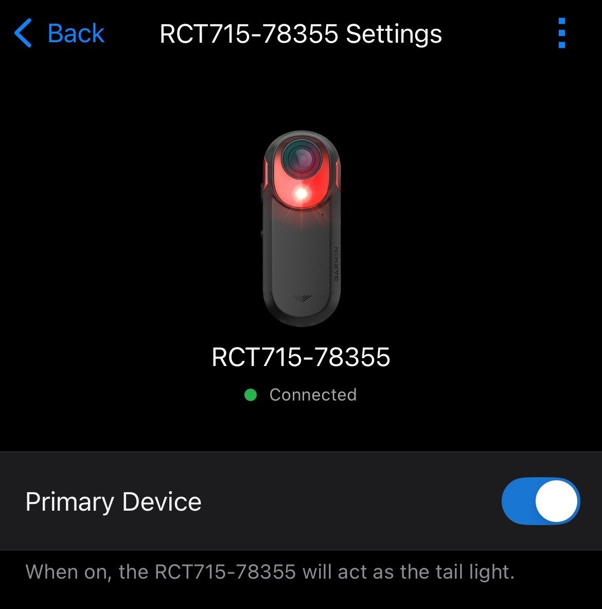

Setting a Primary Device in the Varia App
When multiple headlights or rear radars are paired to the Varia app, one will need to be set as the primary device. If a radar or headlight is not set as the primary device, it will not connect to the app even if it is listed in the Devices menu. If your headlight or taillight is not connecting to the app, you may need to set it as the primary device. To change the primary device:
  1. In the Varia app, select three blue dots stacked vertically (top right).
  2. Select Devices.
  3. Select the device you would like to make the primary device.
  4. Enable the Primary Device option.
    Varia app settings page for RCT715 with option for primary device enabled
