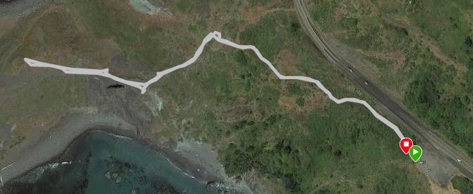

    Track Example
    The difference between using Expedition Mode and not using Expedition Mode is shown by the blue track below. The track recorded with Expedition Mode enabled has less defined corners than the track recorded when not in Expedition Mode.
    In Expedition ModeNot in Expedition Mode
    In Expedition ModeNot In Expedition Mode
