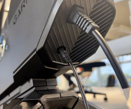

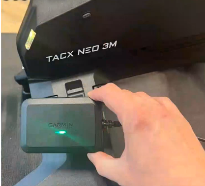

The Tacx® Network Adapter, sold separately, allows you to control the Tacx® NEO 3M smart trainer via Wi-Fi or wired ethernet connection. The network adapter plugs directly into the trainer below the power adapter.
NOTE: The trainer must be connected to power while using the Network Adapter.
Network Adapter Allows Direct Connection
Network Adapter NEO 3M plugged in below the power cable
LED on the NEO 3M Is Yellow When Controlled With the Network Adapter

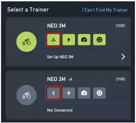

  11. The NEO 3M will now show as two pairing options in the app:
      • Via BLE
      • Via Wi-Fi
    NEO 3M pairing in app via wi-fi

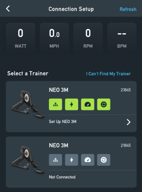

    NOTE: Below is an example of a trainer that has been paired via wi-fi before, but is paired via ethernet currently:
    3M connected via ethernet in the tacx app
