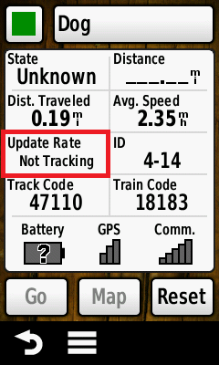

When a dog tracking collar is paired to a handheld device, it is possible to pause or disable tracking. If tracking is stopped like this, it will have to be turned back on through the handheld settings before the dog's location will properly display on the Map or Compass pages.
If tracking has been stopped, a "Not Tracking" message will appear on the Dog Info page as shown in these example images. For instructions on turning tracking back on, click on your handheld model below:
