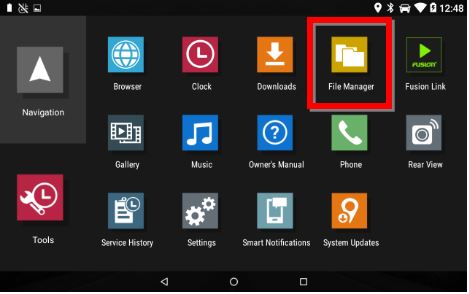

To view the Cyclops Red Light and Speed Camera information:
1. Touch Apps
2.  Touch the Tools Tab
3. Touch File Manager

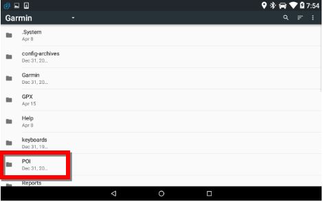

4. Touch Garmin
5. Touch POI
6. Scroll to the bottom and confirm the file USCandaCyclopsSample.gpi is present
The database information should be listed, showing the date the camera database was last updated. This means the information has been successfully added to your device.

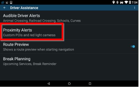

To enable or disable Red Light and Speed Camera or Dangerous Zone alerts:
1. Touch Settings
2. Touch Driver Assistance
3. Touch Proximity Alerts
4. Touch Alerts
5. Check or uncheck the box to enable or disable the desired alerts
6. Touch OK
