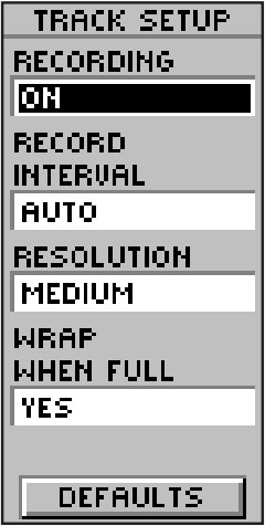

Track Setup
  1. From the MENU page, highlight 'TRACKS,' and press ENTER.
  2. Highlight 'SETUP,' and press ENTER.
  3. Press UP or DOWN to highlight each setup option and make a choice for each. Press PAGE/QUIT to return to the TRACK LOG page.
    eTrex H Track Setup Page

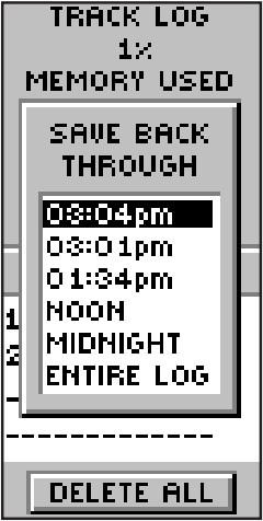

Saving the Current Track Log
  1. From the MENU page, highlight 'TRACKS' and press ENTER. The TRACK LOG page appears.
  2. Press the UP or DOWN button to highlight 'SAVE,' then press ENTER. The SAVE BACK THROUGH window appears giving you a time frame for saving a track or 'ENTIRE LOG.'
    eTrex H Track Save Back Through
  3. Press the UP or DOWN button to highlight 'OK,' then press ENTER.
The track is now saved in the 'SAVED TRACKS' list on the TRACK LOG page.

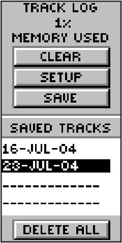

Clearing the Track Log
  1. Press the PAGE button to switch to the MENU page.
  2. Press the UP or DOWN button to highlight 'TRACKS.'
  3. Press ENTER. You are now on the TRACKS page. Press the UP button to highlight 'CLEAR.' Press ENTER.
    eTrex H Track Log Page
  4. Press the DOWN button to highlight 'YES.' Press ENTER. Press the PAGE button to select any page.
