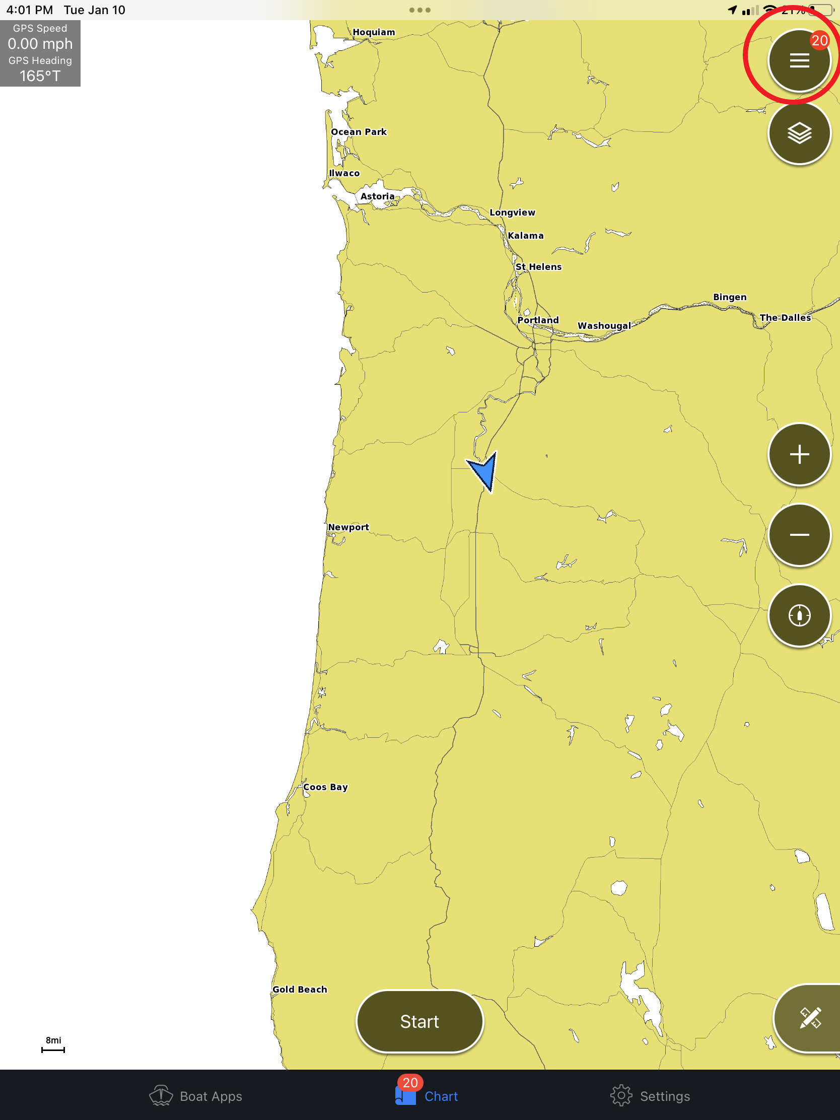

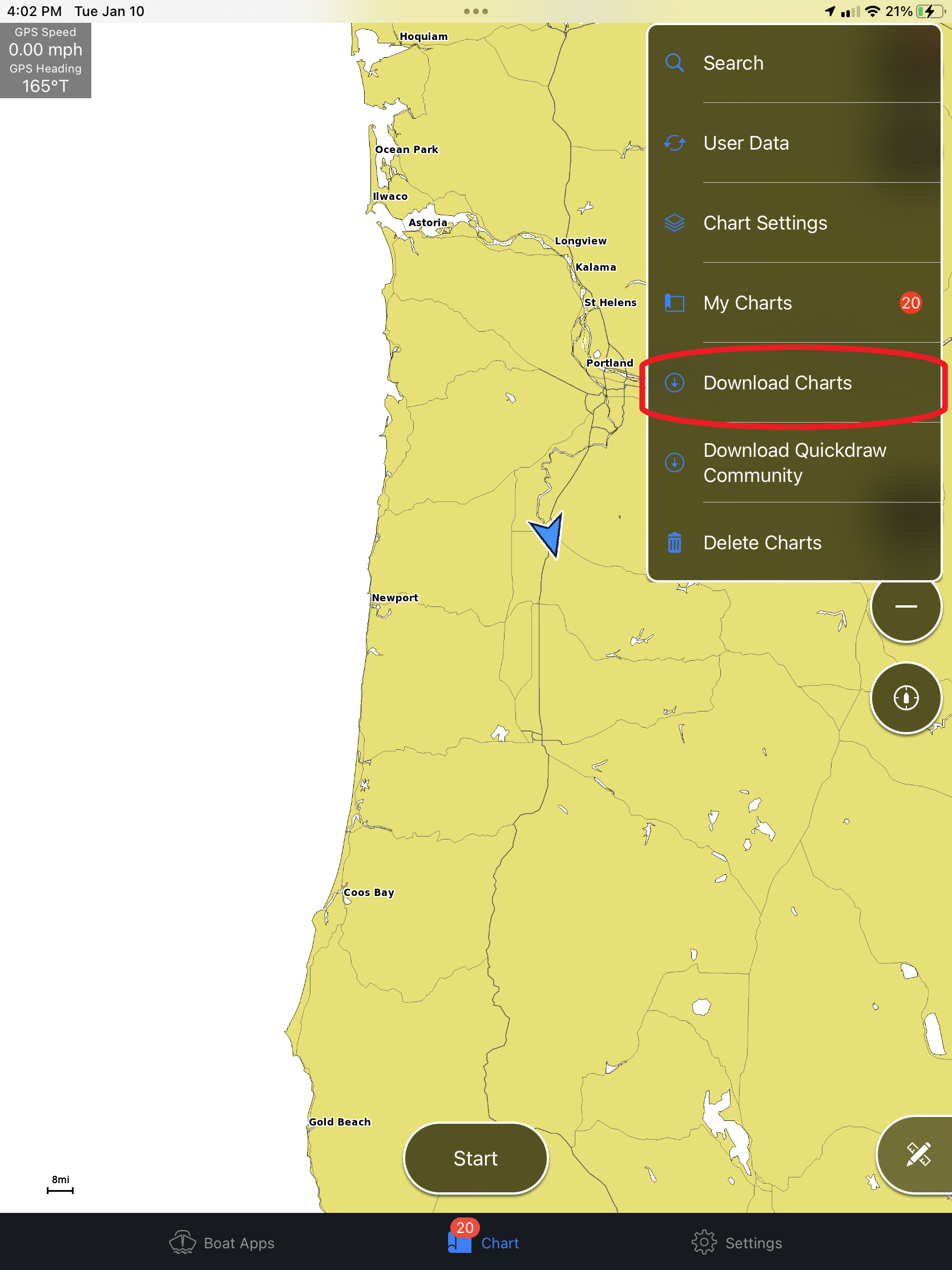

    1. From the chart screen of the app, select the Menu option in the upper right corner of the screen
      AC Menu button 3 lines
    2. Select Download Charts on the new menu that populates
      Download Charts Button

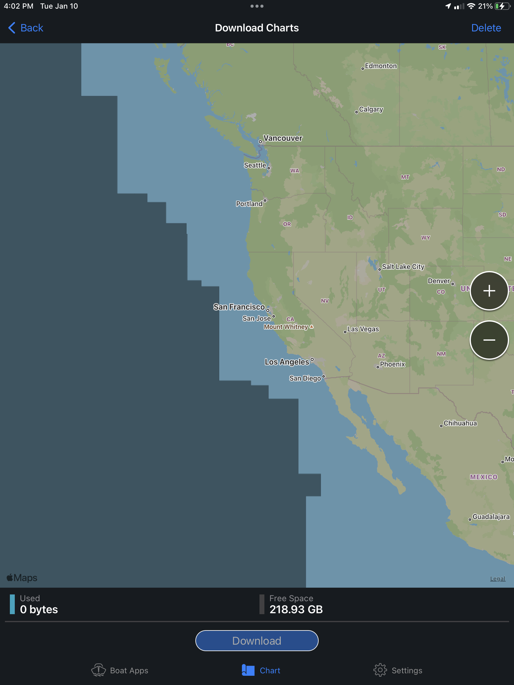

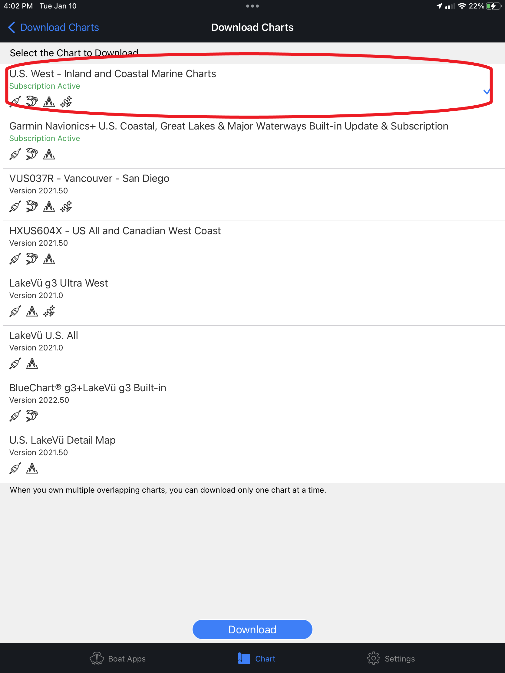

    3. Select the Chart to download from.
      Chart Selection AC

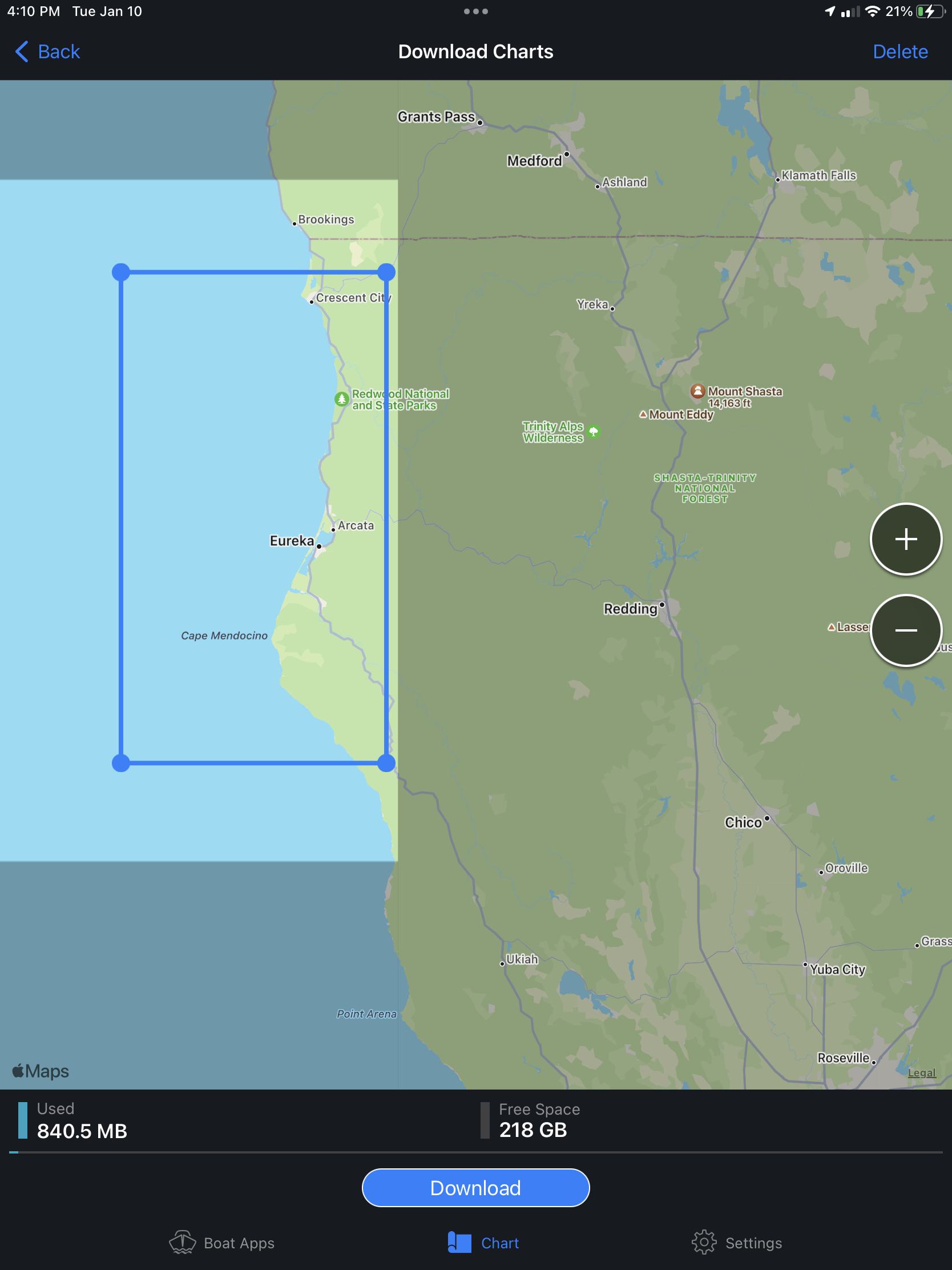

    4. Select the area to download using the selection tool. Once the area is selected the Download button becomes available
      Chart Selection optionsVisable Download button

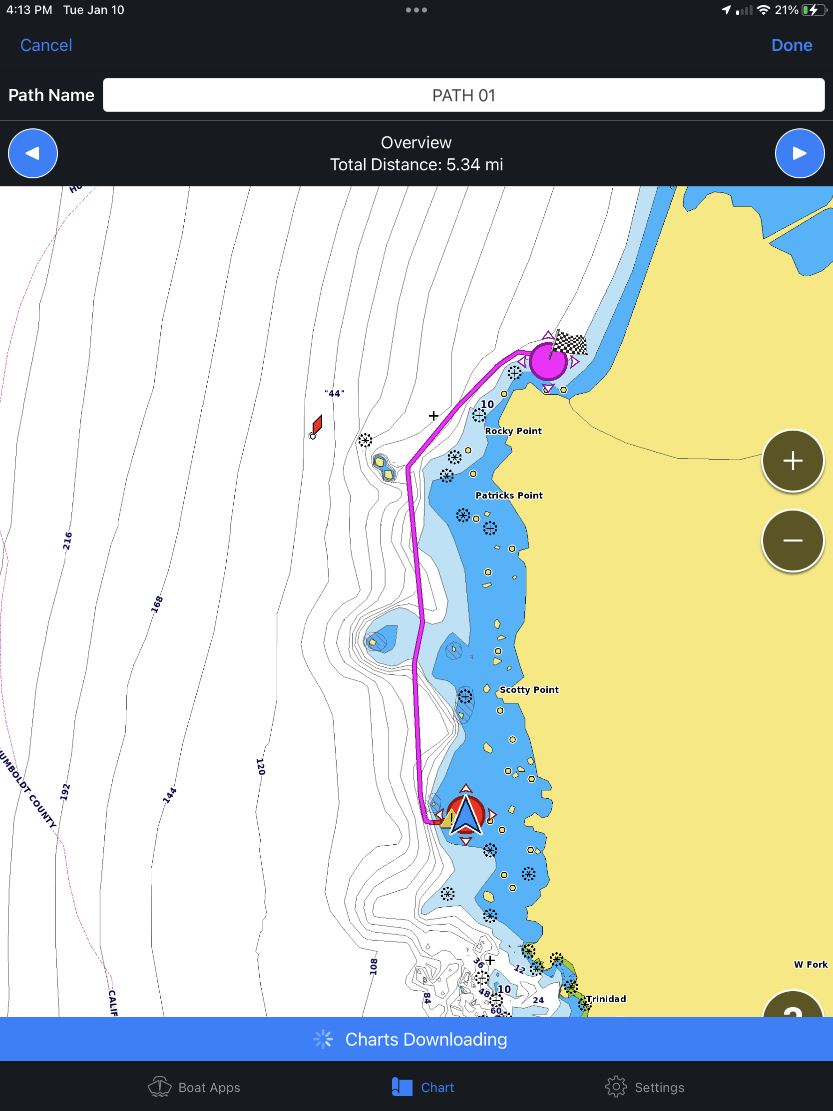

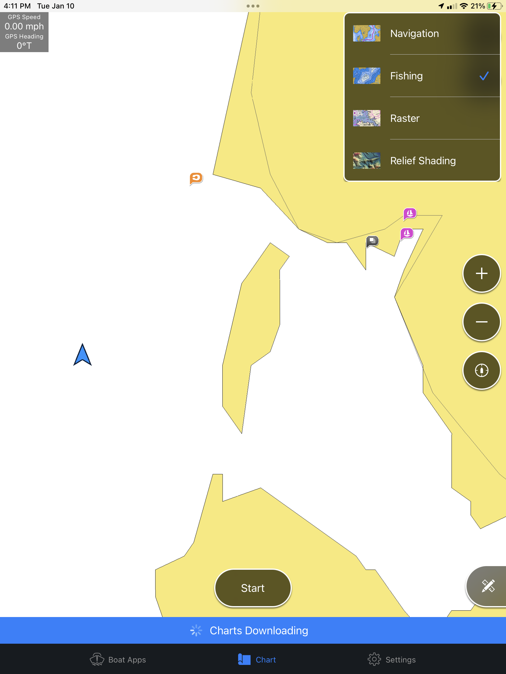

    5. The selected area begins downloading
      Chart downloading progress shown

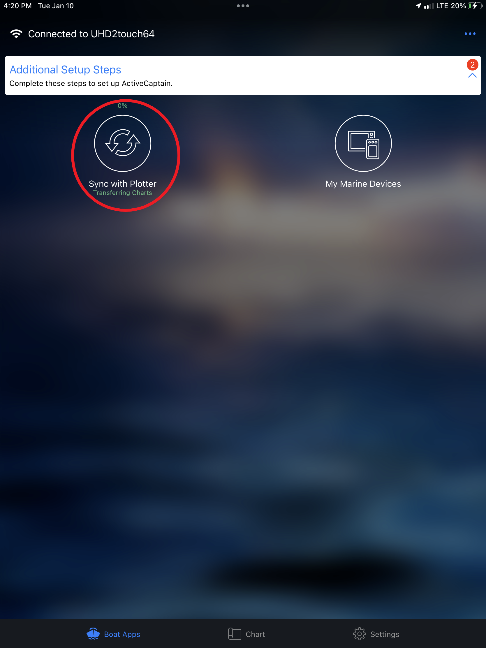

    6. After the download completes, there will be a message stating there are Additional Setup Steps. This will require the mobile device to be connected to the chartplotters Wi-Fi
      Sync with Plotter AC

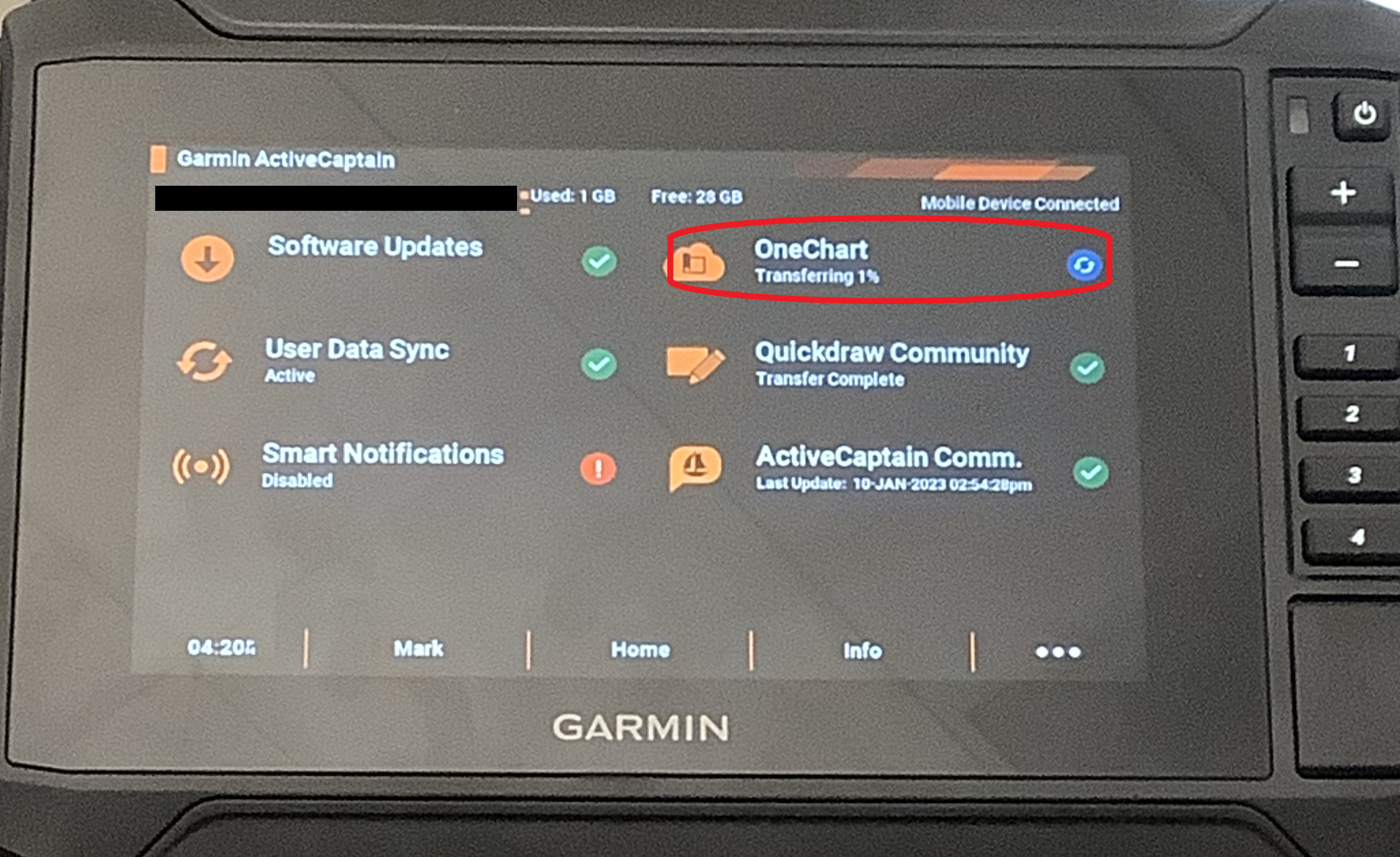

    7. Once connected and Sync with Plotter is selected the transfer between ActiveCaptain and the chartplotter begins
      Transfer to Plotter Transfer Complete message on chartplotter
