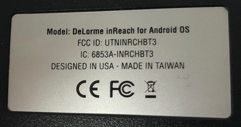

inReach for Android
IMPORTANT
inReach for Android can be identified by the following markings:
  • inReach will be written in Blue
  • It will say "DeLorme inReach for Android OS" on a sticker on the left side of the inReach
  1. Download the needed files from the following link: https://files.delorme.com/inReachFW/prod/batchfiles/bootappbluetooth.1.0.zip
  2. Locate the Zip file on your computer
    NOTE: Usually this will be found in your Downloads. The Zip file will be named AppBlueooth.1.0.zip.
  3. Extract the Zip file to your Desktop
  4. With the inReach powered off, connect it to the computer
  5. Press and hold the Tracking and Message buttons, then press and hold Power until the inReach powers on
  6. Double-click the RunME.bat file in the extracted folder from Step 2
    RunMe.Bat Example
  7. Once done, the inReach will power off - Do not disconnect the inReach until the update is complete
Test the device to make sure it is now transmitting tracks with the correct date and time.

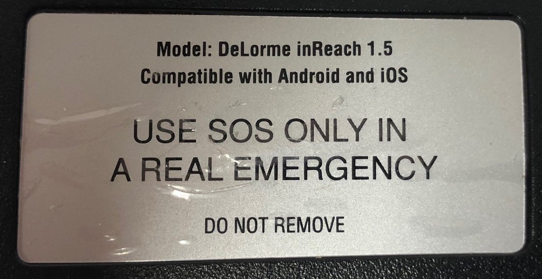

inReach for Smartphones
IMPORTANT
inReach for Smartphone can be identified by the following markings:
  • inReach will be written in Blue (or in some cases Green)
  • It will say "DeLorme inReach 1.5 Compatible with Android and iOS" on a sticker on the left side of the inReach
  1. Download the needed files from the following link: https://files.delorme.com/inReachFW/prod/batchfiles/bootappbluetooth.1.5.zip
  2. Locate the Zip File on your computer
    NOTE: Usually this will be found in your Downloads. The Zip File will be named AppBluetooth.1.5.zip.
  3. Extract the Zip File to your Desktop
    RunMe.bat Example
