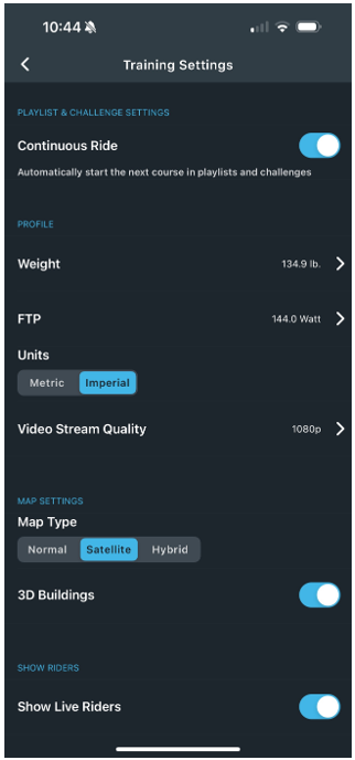

Locate the Setting
This feature is enabled by default, however you can enable or disable it using the following steps:
  1. Open the Tacx Training app or Tacx Desktop app.
  2. Select Settings
  3. Select Training or Training Settings.
  4. Toggle Continuous Ride off or on.

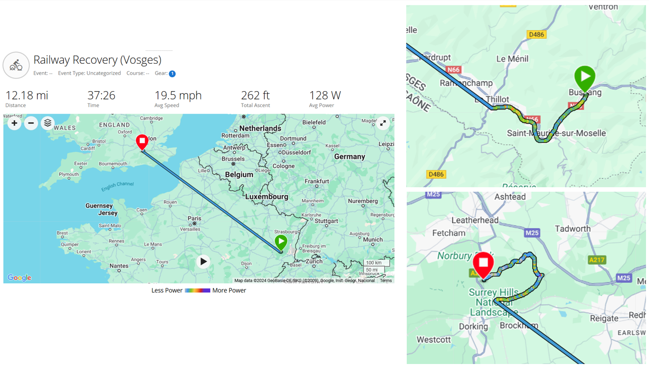

How Will the Ride Appear When Uploaded?
When riding two or more films in one your upload will show the map for both locations. The name of the activity will show the name of the first film started, the other rides will not be mentioned in the activity summary. The line between the two rides does not affect the total elevation gain of the ride. Below is an example of the activity summary's GPS and what the first and second ride look like.
