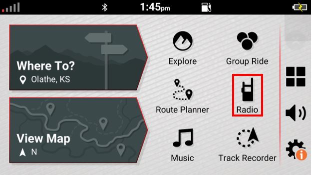

You can Adjust the Squelch and change between CTCSS, DCS, and Open Squelch Modes to improve Audio Quality and Avoid Radio Interference in your Area:
1. Touch Radio.
2. Touch one of the following options below.
- Touch Preset to view the available radio presets.
- Touch Channel to view the available MURS channels.
- Touch Open (Manually adjust squelch for static noise), CTCSS (Continuous Tone-Coded Squelch System), or DCS (Digital Code Squelch) depending on what current mode is selected to view the additional options.
3. To Choose a squelch code within the current mode, select the plus or minus.
