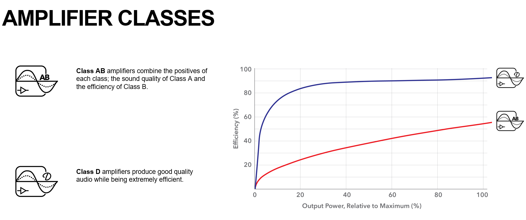

The graph below gives a visual example that demonstrates the vast difference in efficiency to power output when comparing Class-D amplifiers against Class-AB amplifiers.
Amplifier Class Comparison Diagram
Apollo series stereos with 2-ohm stable Class-D Internal Amplifiers
