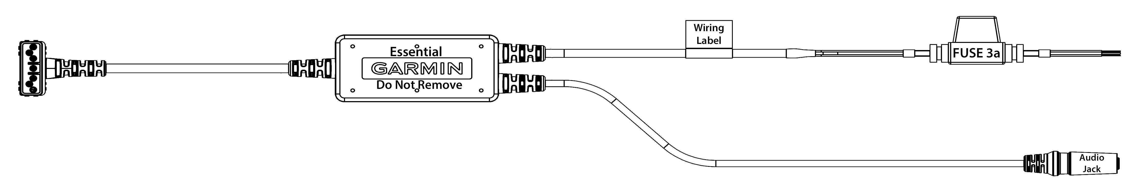

  • Voltage is only applied to the pins of the AMPS Rugged Mount for the Montana 7xx series when the mount detects that a device has been inserted in the cradle.
  • The mount should not be altered in any way when being installed, such as cutting the audio jack or removing the junction "brick".
  • All wires that are not utilized (including the Audio Jack) should be insulated.
Montana Mount Wiring
