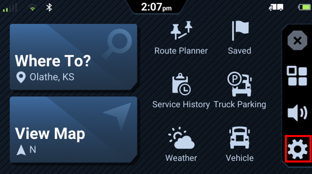

1. Plug the device into a power source

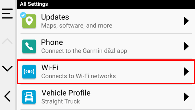

2. Touch Settings
3. Touch Wi-Fi

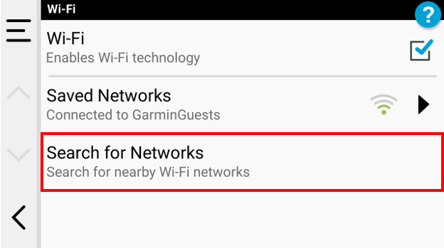

5. Touch Search for Networks
6. Select a network
7. Enter the password for the network and select Done if necessary
The device should then connect to the network. The network will be added to the list of saved networks. The device will reconnect to this network automatically when it is within range.

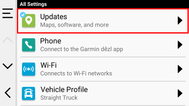

1. Touch Settings
2. Touch Updates

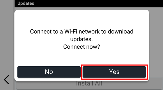

3. Touch Yes, then select the desired Wi-Fi network if prompted to connect to a Wi-Fi network
The device will check for available updates once connected to a Wi-Fi network. A prompt will appear to install them if any are found.
