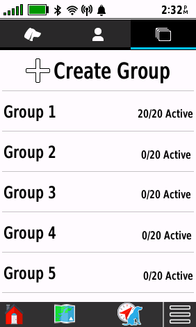

Using groups can allow you to pair up to 250 devices to your handheld. This can be beneficial for more than one reason:

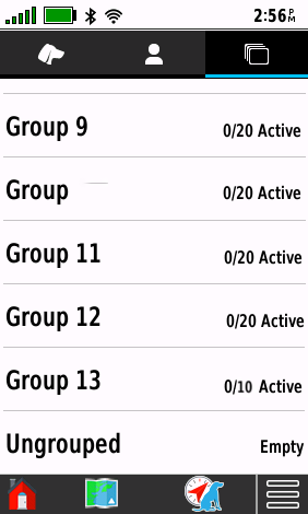

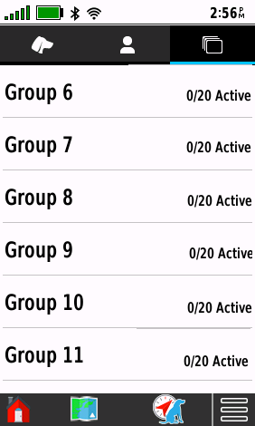

To pair 250 devices you will need multiple groups. Keeping in mind that you can only have 20 active devices at a time. The easiest example of this is having 12 groups of 20 dogs or contacts and 1 group of 10. That will give you 250 devices that are paired to that handheld.
Active 20 dogs Inactive 20 dogs  group 6 to 11  group 9 to ungrouped

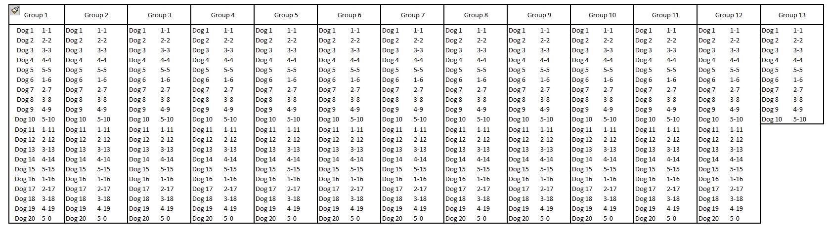

Example Chart With Dog IDs for 250 dogs
pairing 250
