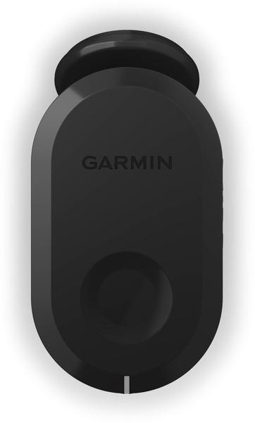

Understanding the LED Colors on the Remote Cam
The Garmin Catalyst Remote Cam has a status LED light that displays different colors depending on the device status. Below is a breakdown of the different LED meanings. Some colors can have more than one meaning
Green
  • Remote Cam is booted and on standby.  It will remain in standby until a session is started on the Catalyst.
Pulsing Green
  • Remote Cam is booting
Blinking Green
  • An update is being installed
Solid Red
  • Transmitting Video
No Light
  • Remote Cam is off
  • Remote Cam is plugged into the Catalyst mount, but the Catalyst itself is not attached to the mount
