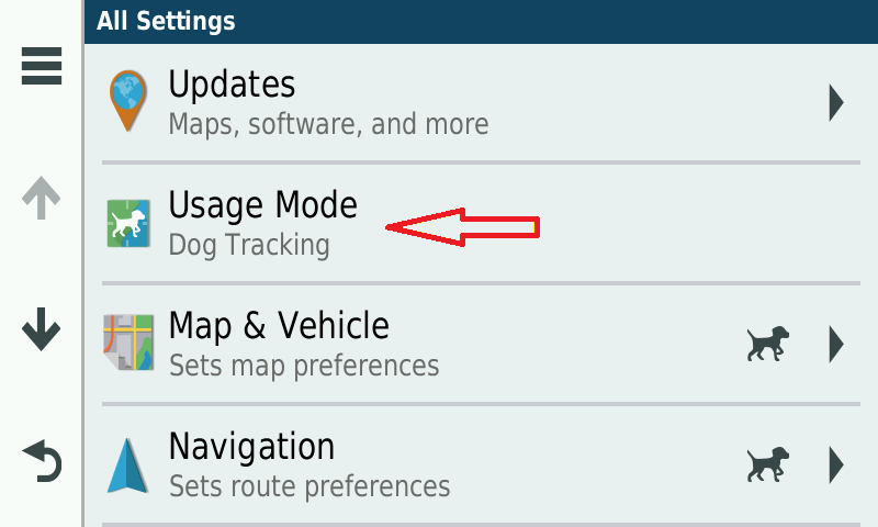

1. From the Home Screen - Tap on Settings
2. Verify the Usage Mode is Set to Dog Tracking

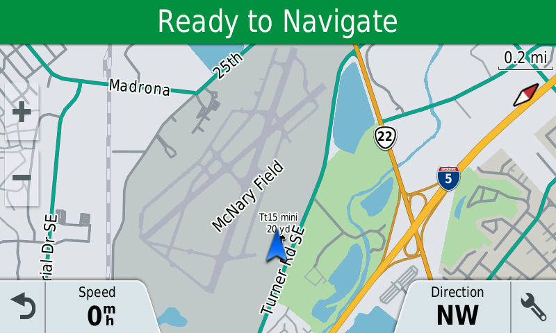

3. Return to the Home Screen

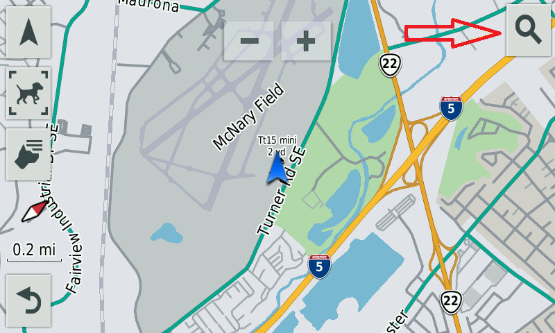

4. Select View Map and Tap the Screen without selecting any Dogs or Points of Interest
5. Tap the Magnify Glass
    • If the Magnify Glass disappears, tap a second time

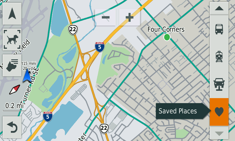

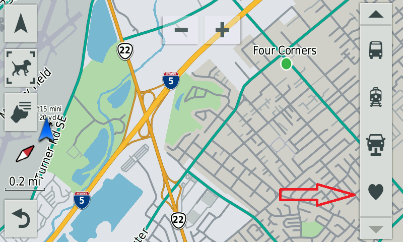

6. Scroll Down by selecting the Down Arrow
7. Select the Heart Icon for Saved Places
Your Waypoints are shown on the Map

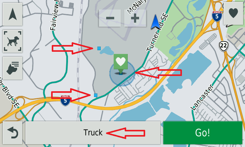

8. As you Select the Waypoint by a tapping the icon, the description is listed below.

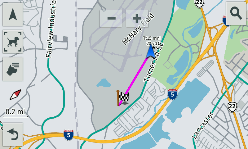

9. Select Go and Navigation will begin
