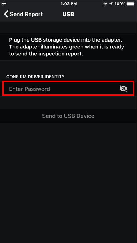

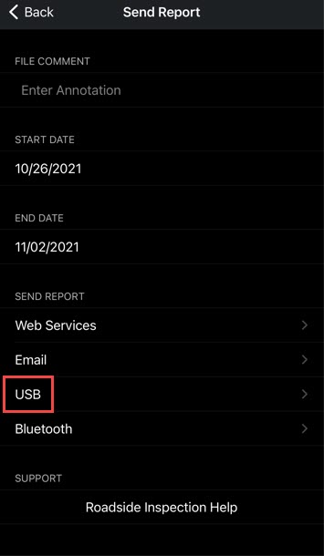

iOS
1. Open the Garmin eLog app
2. Sign in to your driver profile
3. Touch Inspection
4. Touch Send Report
  • Review data for accuracy prior to sending the report.
5. Touch Yes
6. Enter an annotation if necessary
  • Any key phrase or code provided by the DOT officer during the inspection should be entered here
    • Special characters and spaces are not permitted and there is a maximum of 60 characters
7. Change the date range if necessary
8. Touch USB
9. Connect the inspector's USB flash drive to the USB port on the Garmin eLog adapter
10. Enter your password to confirm your identity
11. Touch Send to USB Device
12. Remove USB when the process completes
The files will now be transferred to the USB flash drive.

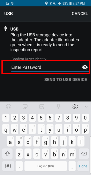

Android
3. Touch Inspection
4. Touch the send reports icon
5. Touch Yes
8. Touch USB
