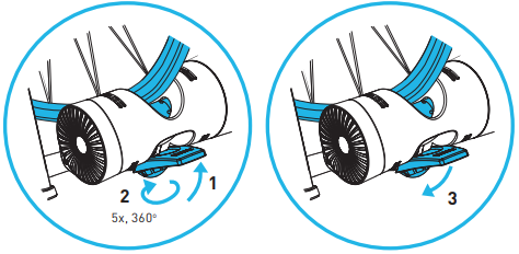

Step 8: Complete Roller Adjustment
Pull up the lever to release the rear wheel and rotate the knob 360 degrees clockwise five full times. Then push down the lever. This will provide optimal performance in the Tacx Training app.
Rotation of the knob under the resistance unit lever

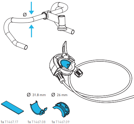

Measure the diameter of your handlebars and place the proper insert in the resistance lever.
Sizing resistance lever for handlebars

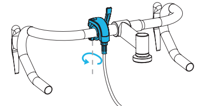

Place the resistance lever on your handlebars and tighten it by turning the knob.
Installing resistance lever on handlebars
