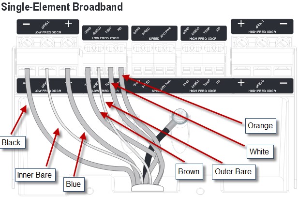

Wiring Diagrams for Airmar Transducers Compatible with the GSD™ 26 Sonar Module
Select a transducer model below to view the wiring diagram needed when connecting to a GSD™ 26 sonar module.
If the transducer is not listed below, see GSD 24 Compatible Transducers Wiring Diagram for wiring information about the GSD 24. Transducers listed for the GSD™ 24 sonar module can connect to the GSD 26 on either the low-frequency or high-frequency side.
For questions about wire colors and functions of Airmar transducers, contact Airmar distributor Gemeco at 1-803-693-0777.

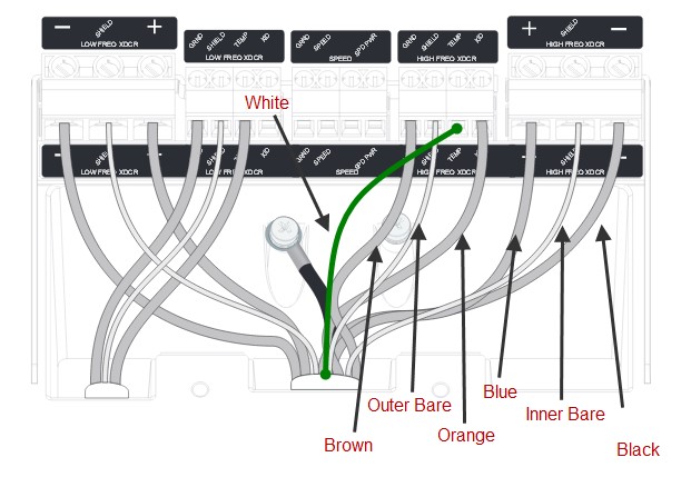

Airmar R509LH
Garmin Part Number: 010-11640-20
Airmar Part Number: R509LH
**The Blue/White wire will be a Yellow wire if manufactured before November 2010.
Airmar 509LH Wiring Diagram Example

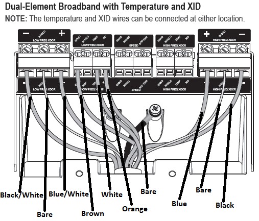

Plastic In-hull Mount Transducer with Depth – Airmar R599LH
Garmin Part Number: 010-11641-20
Airmar Part Number: R599LH
**The blue/white wire will be yellow if manufactured before November 2010.
Airmar 599LH Wiring Diagram Example

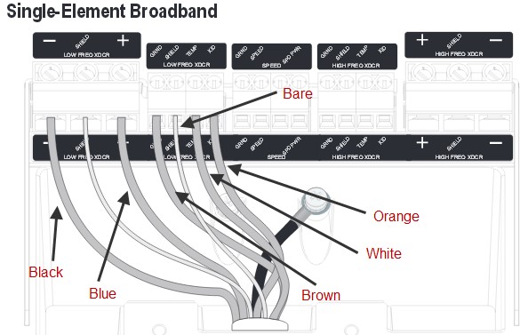

Plastic Thru-hull Mount Transducer with Depth & Temperature - Airmar R109LH
Garmin Part Number: 010-11642-20
Airmar Part Number: R109LH
Airmar R109LH Wiring Diagram Example

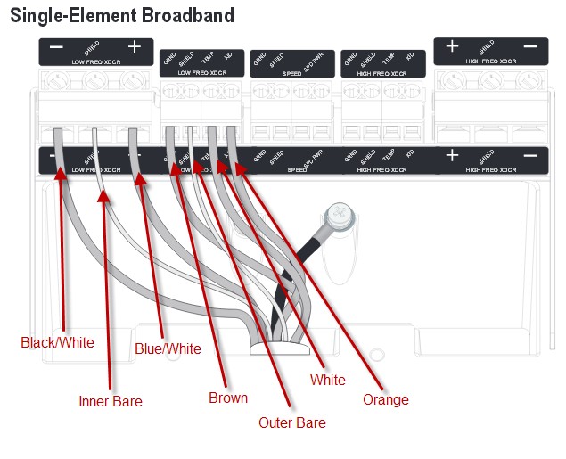

Airmar R111LH
Garmin Part Number: 010-11643-20
Airmar Part Number: R111LH
Airmar R111LH Wiring Diagram Example

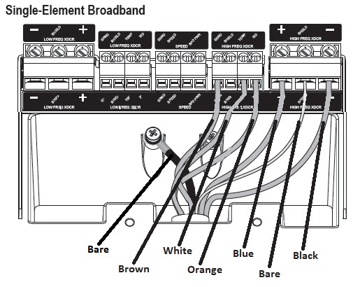

Plastic In-hull Mount Transducer with Depth - Airmar M265LH
Garmin Part Number: 010-11644-20
Airmar Part Number: M265LH
Airmar M265LH Wiring Diagram Example

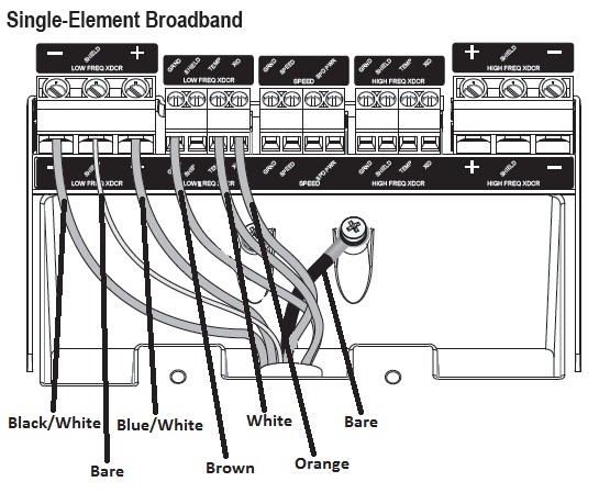

Airmar B265LH
Garmin Part Number: 010-11645-20
Airmar Part Number: B265LH
Airmar B265LH Wiring Diagram Example
