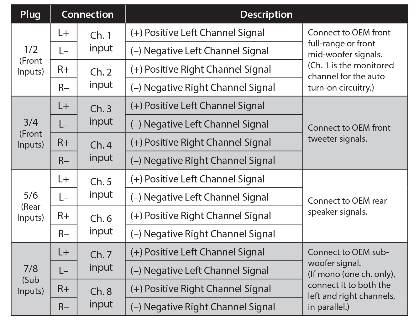

Designed to retain OEM fader functionality, the FiX® 86 accepts full-range or band-limited factory outputs (up to 3-way front + 2-way rear) from an OEM audio source (250 mV – 30 V RMS). Engineered to combat induced cable noise, the input architecture is set up in a differential-balanced configuration, making these inputs compatible with virtually any analog audio signal. Connections are made via four plugs located on the side of the unit labeled “OEM Analog Inputs”. Each 4-pin plug accepts two channels of audio input, separated in pairs (Left and Right).
Depending on the specific architecture of your OEM system, you will need to locate suitable connection points to provide appropriate input signals to the FiX® 86, while maintaining OEM fader functionality. It is recommended to obtain a service manual for the vehicle you are working on to locate and identify the correct OEM wires. Refer to the table below when making connections with your OEM audio source.
Note: With most factory audio systems, it is not necessary to connect all eight input channels of the FiX® 86. We recommend using the least amount of inputs needed to create a full-range audio signal, while retaining your fader’s functionality.
FiX 86 OEM Input Chart
It is vital to observe the correct electrical polarity of each channel’s input signal. Failure to do so can result in improper calibration, loss of signal and poor performance.
