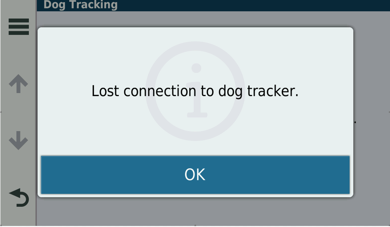

DriveTrack 70 or DriveTrack 71 Lost Connection to Dog Tracker
The dog tracking screen of the DriveTrack™ 70 LMT or DriveTrack™ 71 GPS navigator may display the message "Lost connection to dog tracker" right as the dog tracking handheld has started to communicate with it.

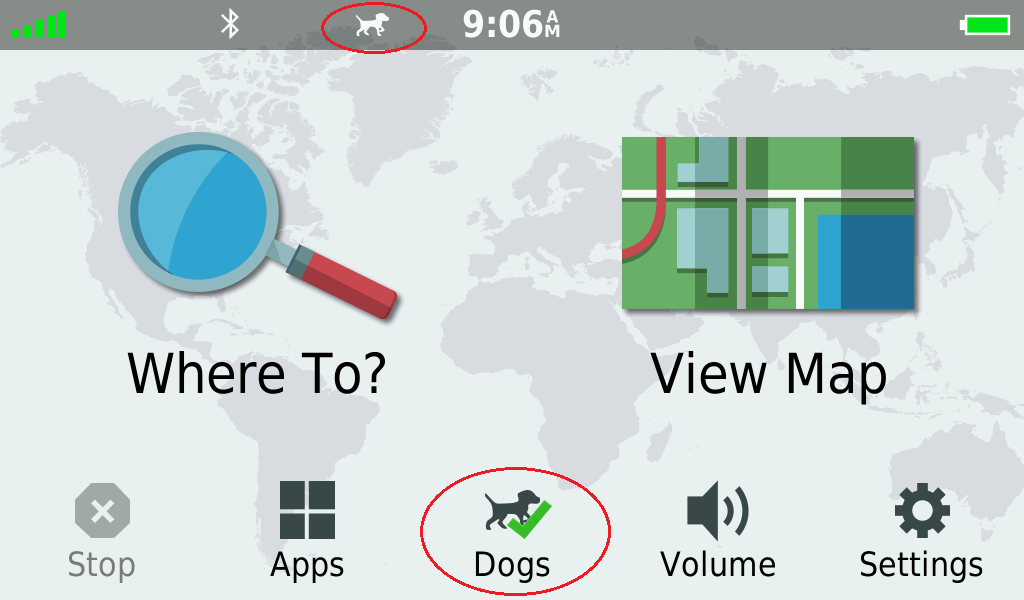

  6. On the DriveTrack navigator's home screen, you should now see the Dogs tracking with a Green Check Mark.
The DriveTrack navigator should now be receiving the broadcast signals from the Handheld.

  6. Once the device fully boots up, it should automatically connect with the handheld that is currently tracking at least one dog
If successful, you should see this when connected to the Handheld again:
