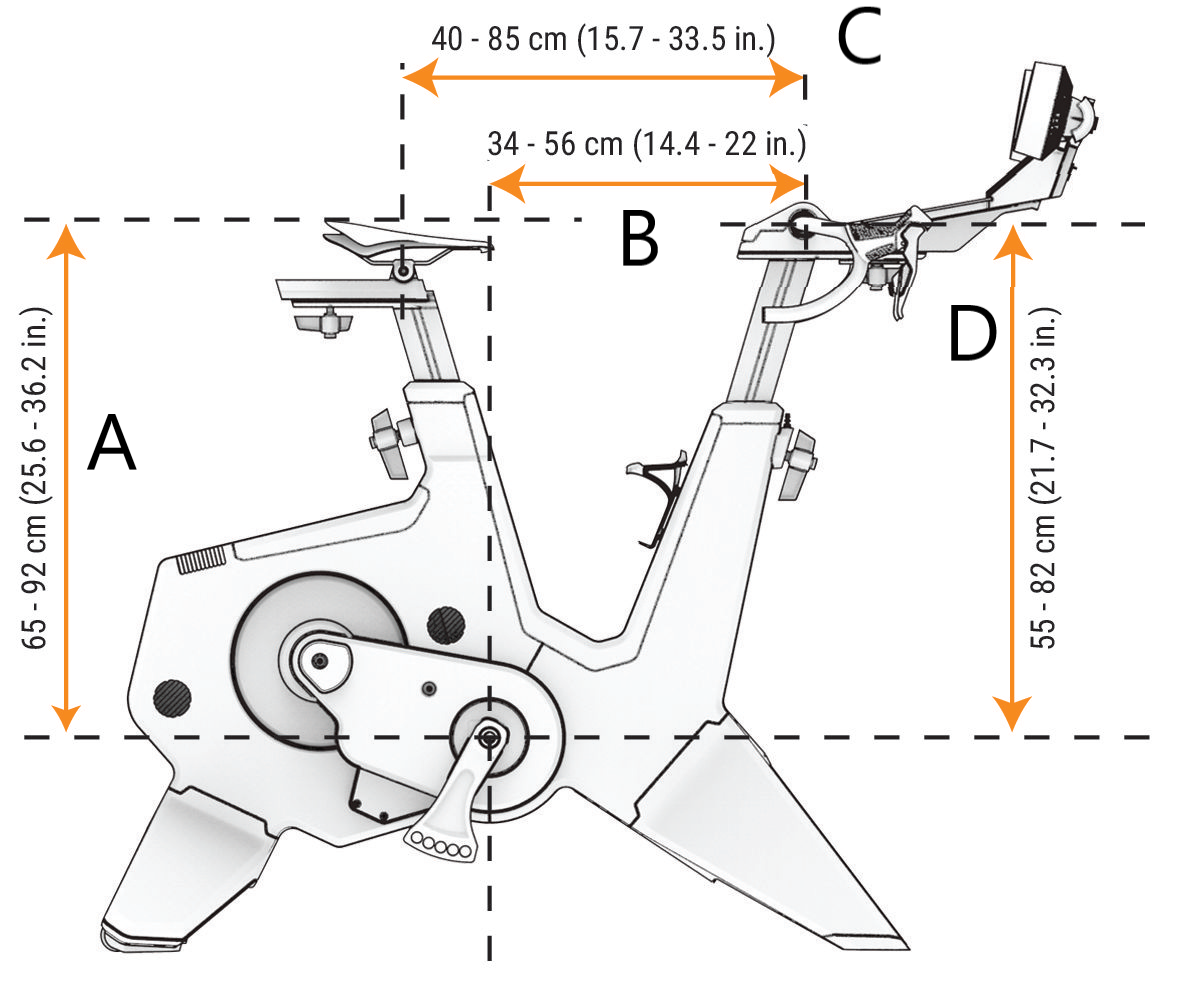

The Tacx© NEO Bike Plus is manufactured so that you can set it up according to the geometry of your road bike. The minimum and maximum dimensions of the height and horizontal positions of the saddle and handlebars are shown in the image below.
NEO Bike Plus Adjustable Geometry
ASaddle Height65 - 92 cm (25.6 - 36.2 in)
BReach34 - 56 cm (14.4 - 22 in)
CVirtual Top Tube40 - 85 cm (15.7 - 33.5 in)
DStack55 - 82 cm (21.7 - 32.3 in)
