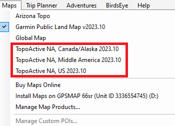

Selecting Maps:
  1. Open Garmin BaseCamp.
  2. Select Maps.
  3. Select the desired map product from the list.
    NOTE: TopoActive and TOPO 24k map products may include multiple files for different regions of a larger coverage area. The map names listed in the settings of BaseCamp or Garmin devices may appear to be duplicate maps at first, but are actually for different regions (e.g. TopoActive US vs. TopoActive Middle America). Make sure to select the correct map region to view map details for the desired area.
    Red square around Map Segments
    Some maps may take an extended amount of time to set up in BaseCamp the first time they are used. The progress can be viewed in the left panel of BaseCamp under the name of the card or device:                                 Windows                                                                                      Mac
