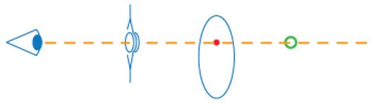

  • While at full draw and depressing the ranging button, Xero bow sights make use of two focal planes that allow the primary pin (red dot) and reticle (green circle) to align for aiming your shot, much like iron sights on a rifle.
    Example of Alignment
    Focal Plane
  • If the red dot is outside the green reticle within the aperture, it is possible that your form is not steady. Not using the same anchor point, or not applying the same grip pressure, that as you used during the initial Calibration Process can cause the sight to appear out of alignment.
