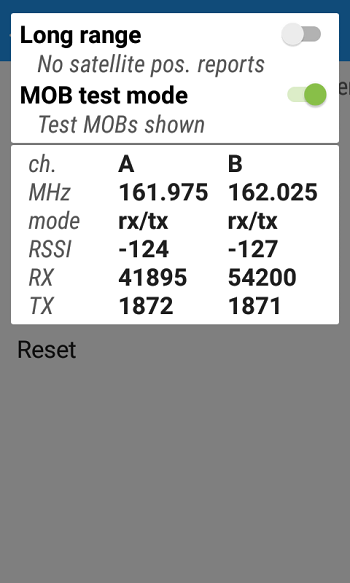

Long Range Position Reports disabled in app
Consideration for Message 27 transmission suppression
Vessels transmit Message 27 once every 3 minutes. One transmission lasts only 17 ms and impact on and possible interference with adjacent channels is thus quite low. However, if there are many vessels transmitting Message 27 in the same area, interference may be observed. Because long-range AIS channels 75 and 76 are located on both sides of the distress and calling channel 16, interference should be avoided. In an area where vessels' AIS reports can be received via Terrestrial AIS base stations, the suppression of Message 27 transmissions should be considered.
